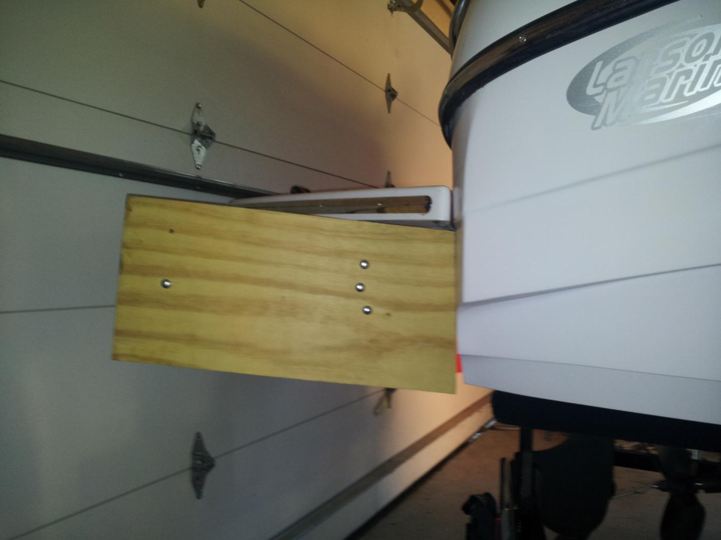

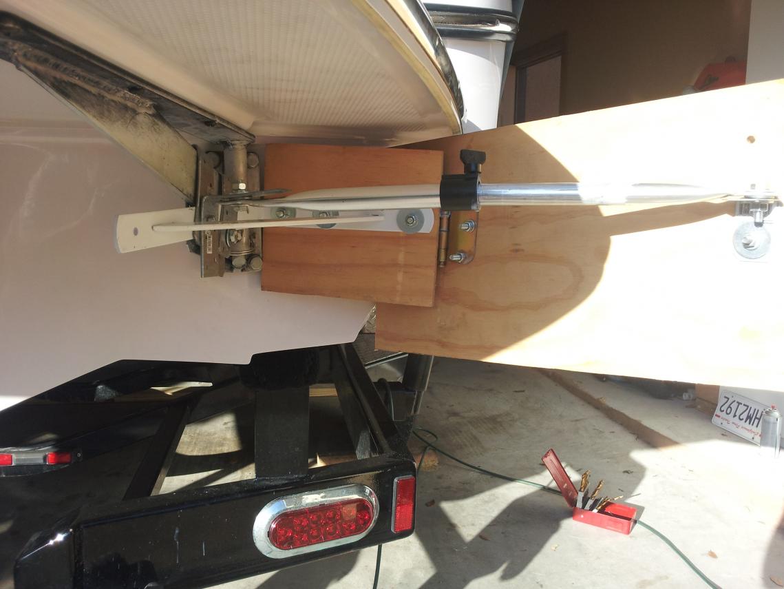

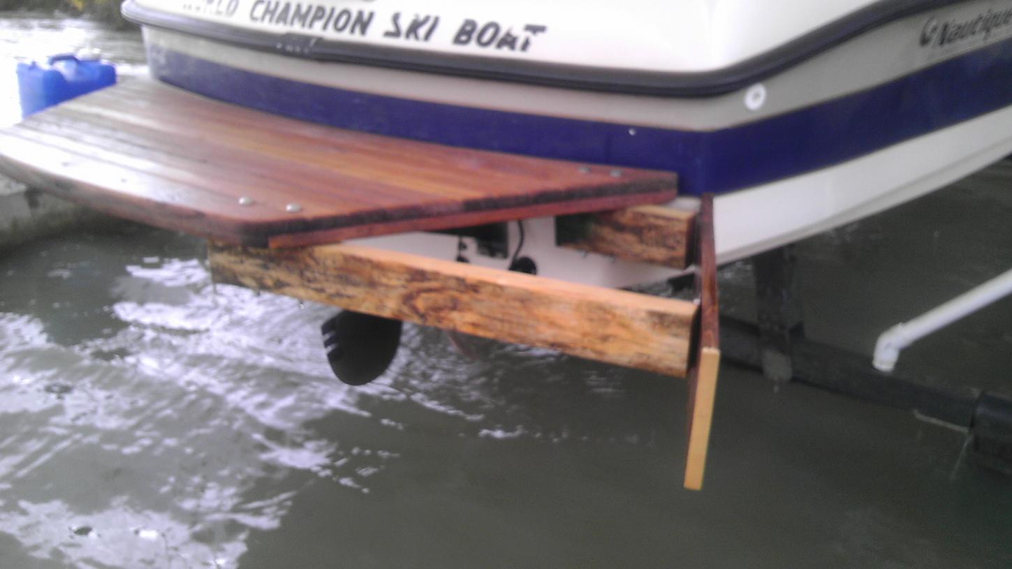

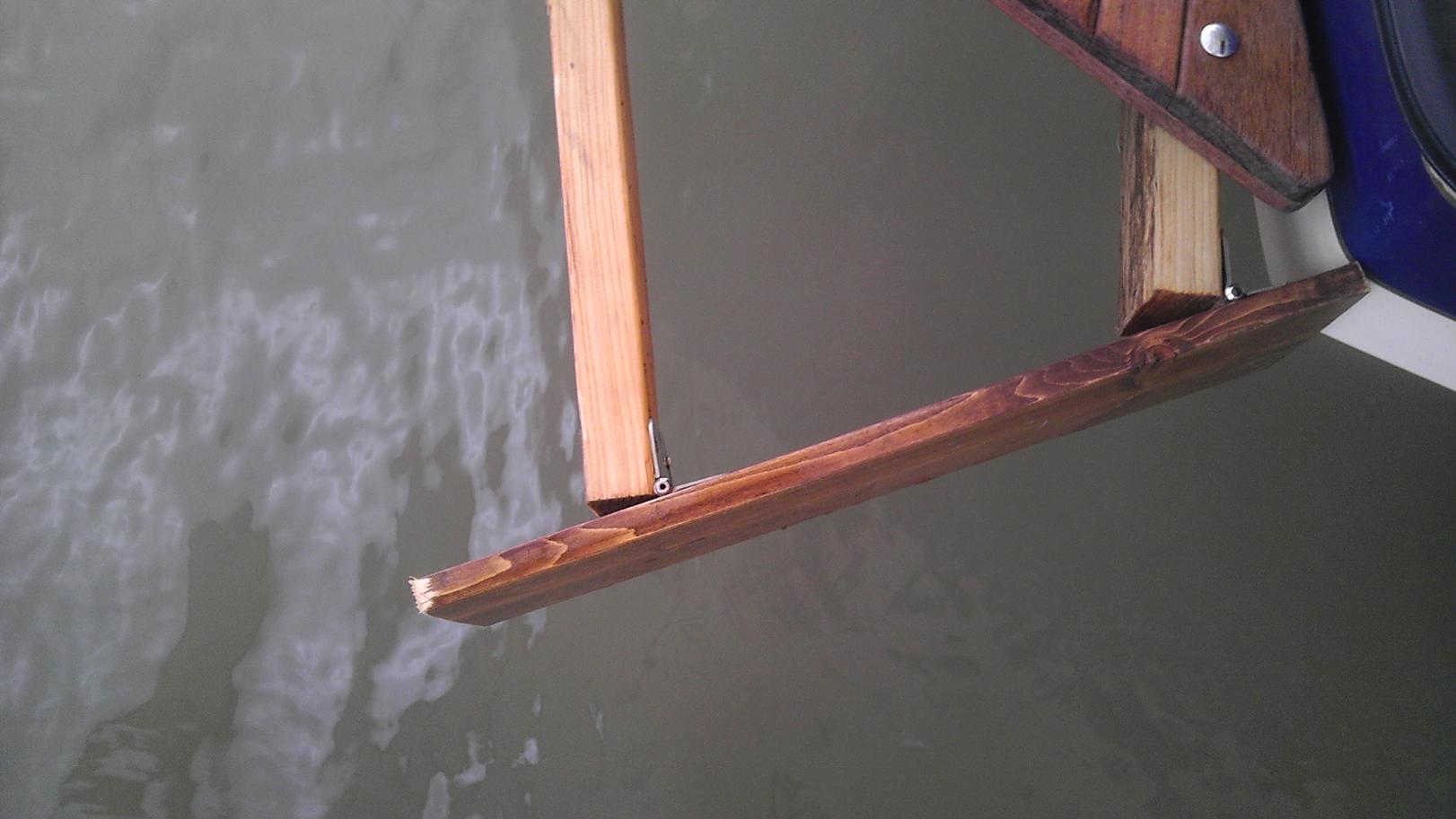

    The prototype: Simple2x4’s connect to the swim deck using 3/8 thru bolts. The 2x4’s have stainless steel hinges on theends connected to a 8x22x1/2 inch stained and sealed pine board. The hinges allow the whole thing to adjustangles if and when I decide to move the 2x4s. This will allow the angle to be adjusted.

      Test 1
      Test 1:
      Weight: 1000 lbs fat sac in center rear of the boat.
      Crew: Driver (160)
      Board: Inland Surfer Blue Lake
      Gate: 8 x 22” at 40 degree offset from hull. Because of the camber of the boat (mydefinition -- the curvature of the hull when looked at from above…similar tolooking at a cross section of a wing) the actual offset is more like 20 degreesfrom the relative forward motion. TheNautique hull for that year group has a pretty severe “taper”.
      Speed: Tested at 8.5mph nominal starting speed as this is the default speed when normally surfingusing side weighting versus a “gate” approach. When through .3 MPH increments to 9.8.
      Observations:
      Not very surfable. The delayed convergence was noticeable but did not allow the wake tobuild up much. Could go ropeless for avery short time but there was really no sweet spot. The wave actually had nice form and was morecleaned up then simply adding weight to that side. The gate was just under the swim platform butthe platform was under water. Thus, afair amount of water was actually going over the top possible reducing theeffectiveness of the gate. Rudderauthority is very poor and at idle I can only make right turns. Obviously, this reiterates the need for aretractable device when I make the final version.
      Follow-on work needed: Increase size of gate so water does not go over top.

          My thoughts now haveturned to the stepped hull of the Nautique. Currently, the gate does not trap the water that comes from the pocket(or cutout in the hull). See picture 3. I might have to deal with this and see if ithelps. The problem is how to deal withthis but not affect the ski wake. I havelooked at the back of the boat at 30 mph and this cutout is actually above thewater but I wonder what the effects are. Suddenly I have gotten pessimistic that I am going to get the results Iwant. The other approach I could takeis to move the pivot point of the gate (where it attaches to the stern) alittle closer to the center of the boat to ensure I capture whatever water iscoming thru the cutout.
          The angle of thegate could be an issue as well. Frankly,I’m not sure whether it needs more or less. I have come up with a modification I can do to my 2x4s so I can adjustthe angle before each run.

                  the picture to look at is #1. If you look at this picture...on the far right part of the hull (under the Nautique sticker) you can see a hull "cutout" starting. It gets progressively bigger. The pic does a poor job of capturing what happens at the end of the boat. By that point, the cutout is a 3 inch L shape (it's actually an L shape but with a 90 degree rotation clockwise). This allows water to pass behind the gate. It is possible that the surfgate concept will only work with boats that do not have this design.
                  You are referring to the tapered chine. To my knowledge, every flat bottomed boat that CC has built since 1982 (ie, not the v-hulled BFN, Excel, Fish, etc) has a tapered chine. Every Ski Nautique from the 2001 forward certainly does.

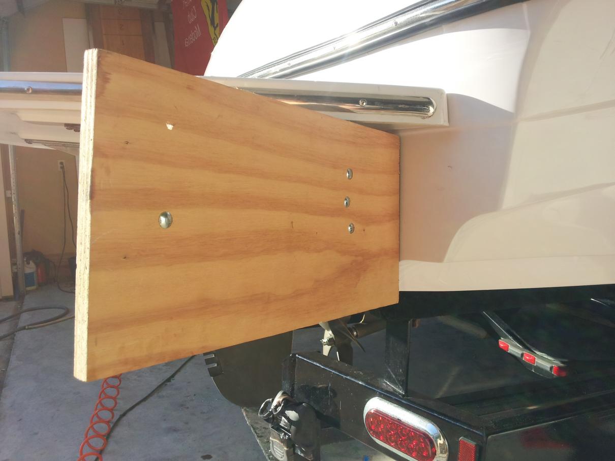

                        Well, I finished my temporary surfgate install. Based upon your results I located the gate to catch most of the water from the chine. Initially I made the gate vertical. Based upon the results, the next version may be tilted to line up with the multiple hull chines. I hope to test it out this weekend. Below are my pics.

                          Looks good. What are the dimensions? I can't wait to hear about the results.

                            The dimensions are 10x21.
