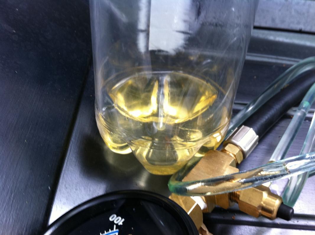

    2. I tested the fuel pressure just before the injectors which was 60psi when cranking, and settled at 50psi after a few minutes.
    3. Pulled about 1/2 a cup of fuel from the fuel injector line and found a few drops of water in it, but could have been in water bottle beforehand...need to retest.

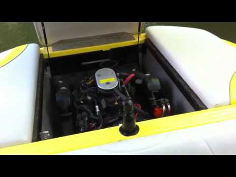

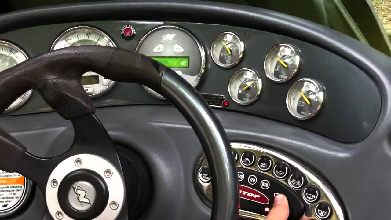

    Video of a 15 second crank.
    Attached photos show fuel pressure and fuel quality.
    I'm now leaning towards bad fuel, flooded, or the fuel injectors are not working.

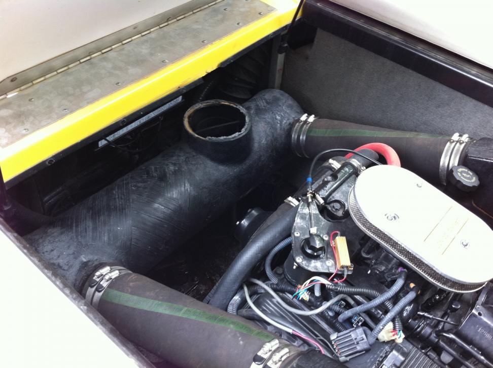

          It just got a **** of a lot worse. I tried cranking again and the engine backfired causing the exhaust manifold to explode...
          I guess its time to take her to the dealer...

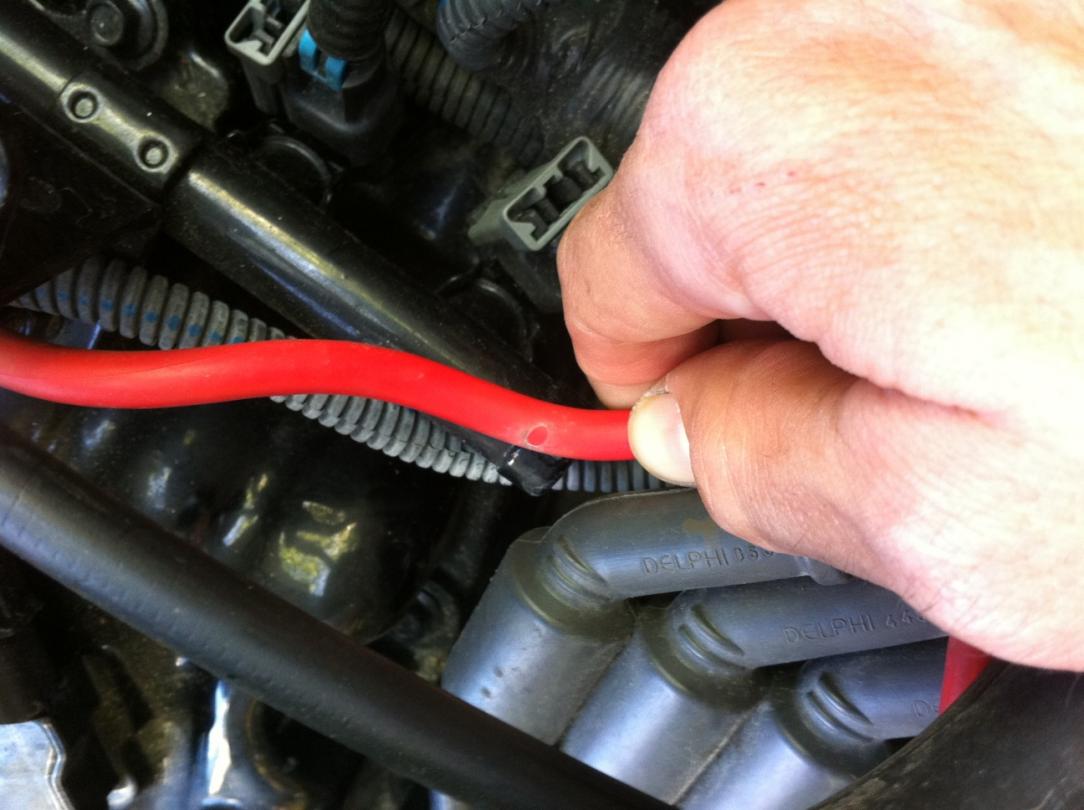

                      Hey WakeSlayer, I tried a brand new lanyard and then jumping the wires but still having the same issue, it seems to backfire every 3rd for 4th time I crank it.
                      I also noticed a very slight burn on the wire between the coil-->distributor from it shorting against the engine block. I rerouted so that it wasn't touching anything but wasn't able to get the engine started. Will still need to replace this wire either way.

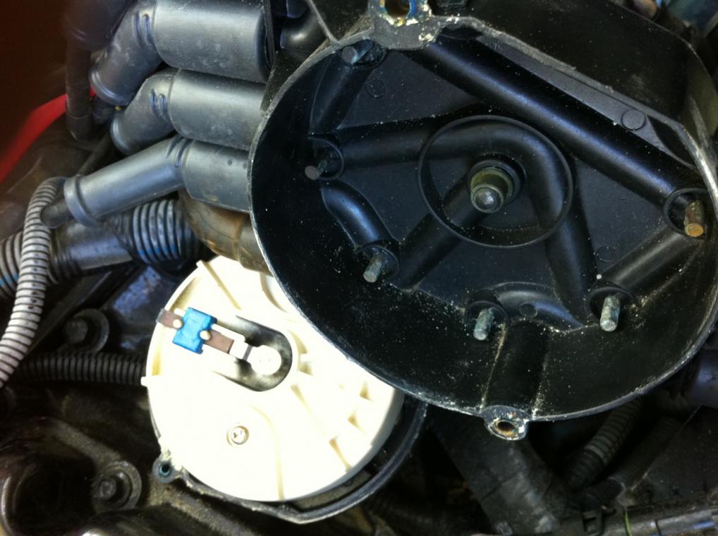

                        Resolved!!!
                        It was the Distributor & rotor...they were both corroded badly!
ID:	361784Click image for larger version
                        Started right up, she is pretty loud with a massive hole in the top of the muffler.
                        Thanks for all the help!
