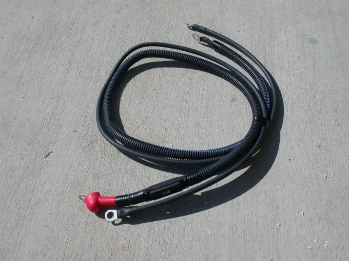

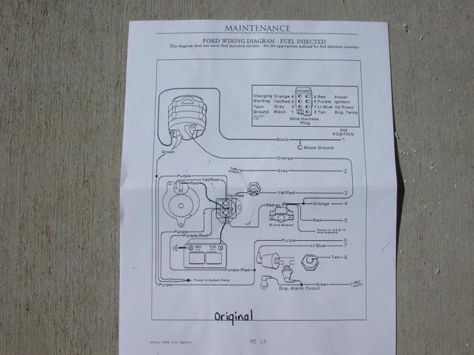

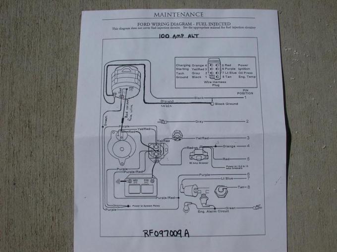

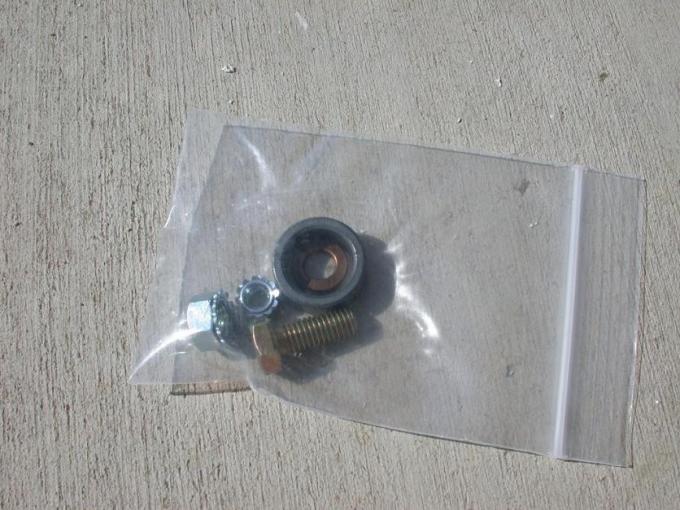

    I got this from my local dealer. Install was easy and all the wiring and hardware came in the kit :mrgreen:

          I just got my 100amp kit from Skidim. It was around 270. It is the same exact kit as shown here.
