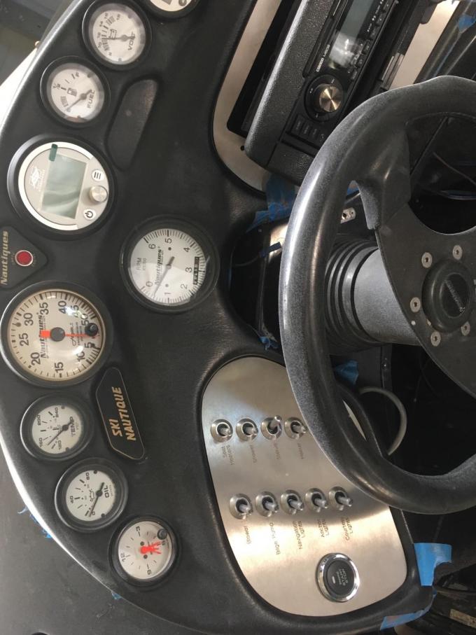

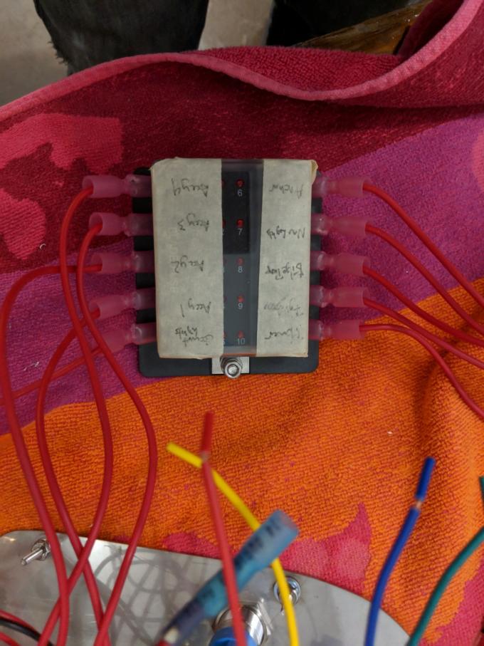

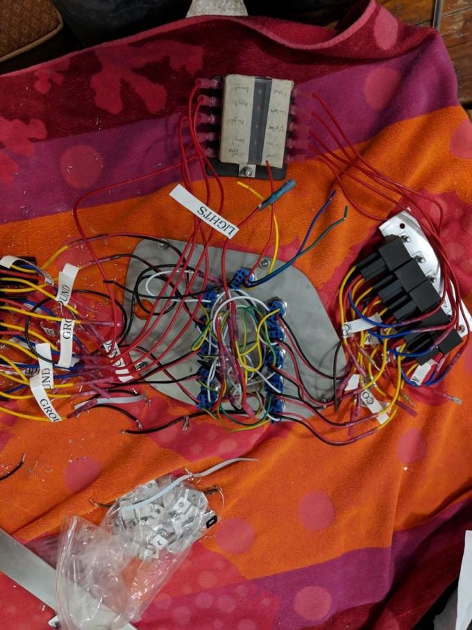

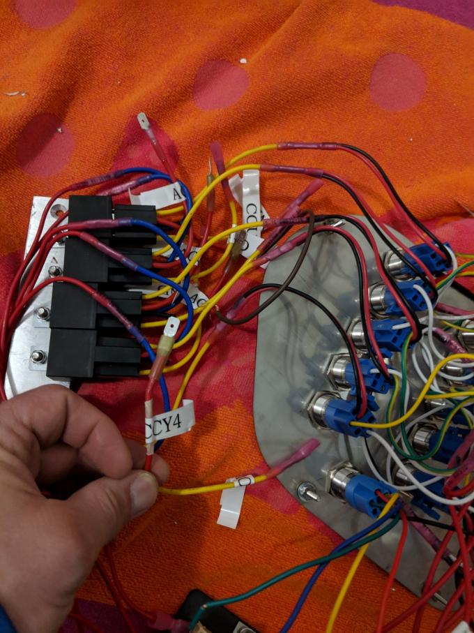

    Here are the pics. There are two wires from each relay . One to the device and one to a ground.
    tthe part I don't know about. There needs to be one power line to the fuse box. The issue is that this power should come from the ignition button or the ignition switch. If this doesn't work I am sending you the in line fuses. With those you will need to just take the existing power from the old breaker switch and connect it to the in line fuse and the corresponding power line that is currently connected to the fuse box.

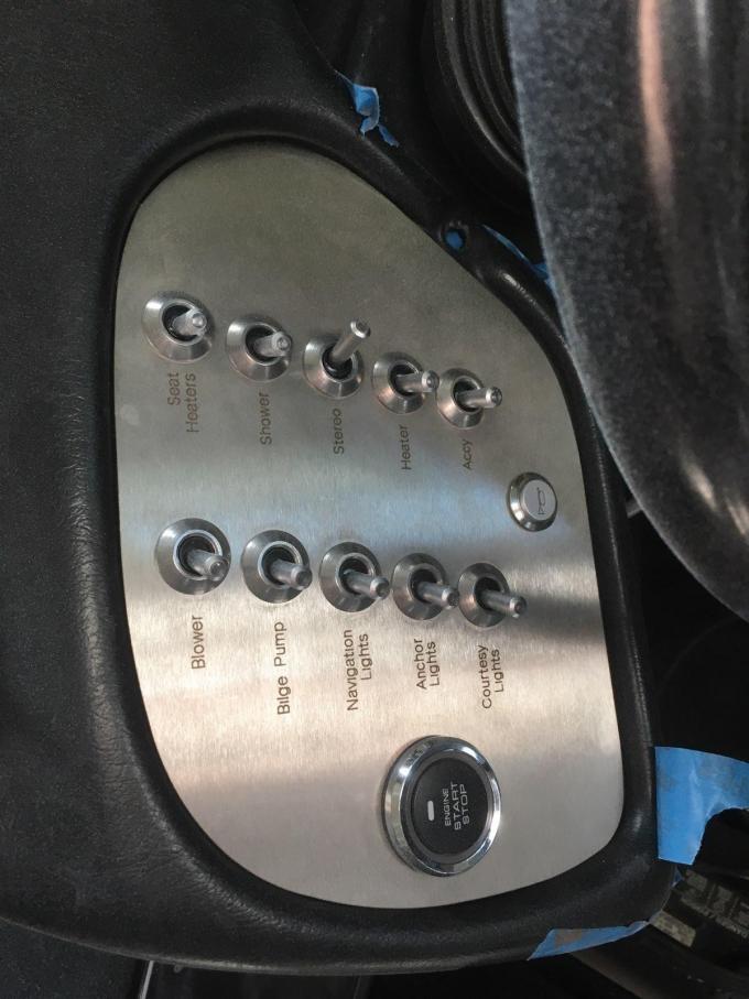

      I got mine installed and they work awesome. The push button and ignition switch version is the same concept just a bit less complicated. They are ready to ship. I have 3 left. Let me know if anyone wants one.
      Steve
