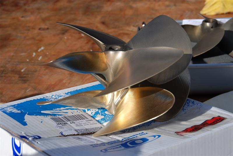

    Since I have had tested a few (6+) props on my 211 OJ actually sent me a prop to test. I was pretty excited since I think the Acme blades are too thin. Unfortunately the OJ was inferior in performance all the way around. I did not notice a big difference in the wake. I did take some pictures of the wake when I was running the OJ, it looks very small at slalom speeds if that is your interest.
