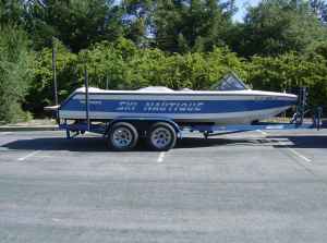

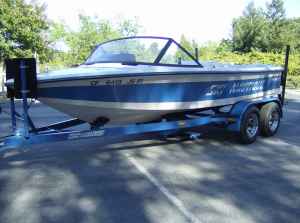

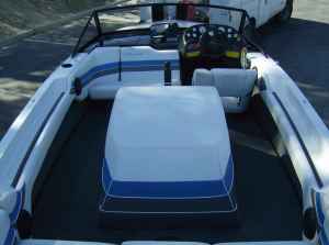

              I will have more pictures soon but in the meantime here are a few from the sale add.
