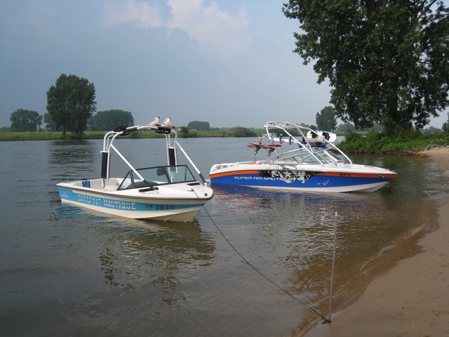

    A big one is hull shape - the barefoot has much more of a "vee" shape and I gather isn't as good for wakeboarding, but will offer some skiing advantages, and ride better in rough water.
    Here's a decent shot of the rear end of each:
    Barefoot
    2001
    How 'bout a little reverse action...

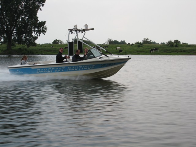

        I would not say the barefoot 2001 has a better wake for wakeboarding then a ski 2001. But it really is a good/excellent wake at 22mph.

              Thanks for all your replies. I do not do anything remotely close to serious skiing. I just wanted a smoother wake than the average boat produces. At the same time the kids like a wake for tubing and boarding. Nice side by side picture. What a huge hull difference. I can see the SN being able to side through turns and the BFN not being able to. I can almost have just as much fun watching these boats and how they handle compared to riding in one.

                              Our 454 Barefoot just don't touch the 50mph.. But it hauls big time... Just slamming the throttle is mean and you just get a smile on your face.. Big time!
