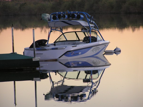

        BTW, Jeff that picture of gramps boat would make a great picture for the calander next year. Great looking boat!

              That is a SWEEEET looking N. That would make a great July pic.
