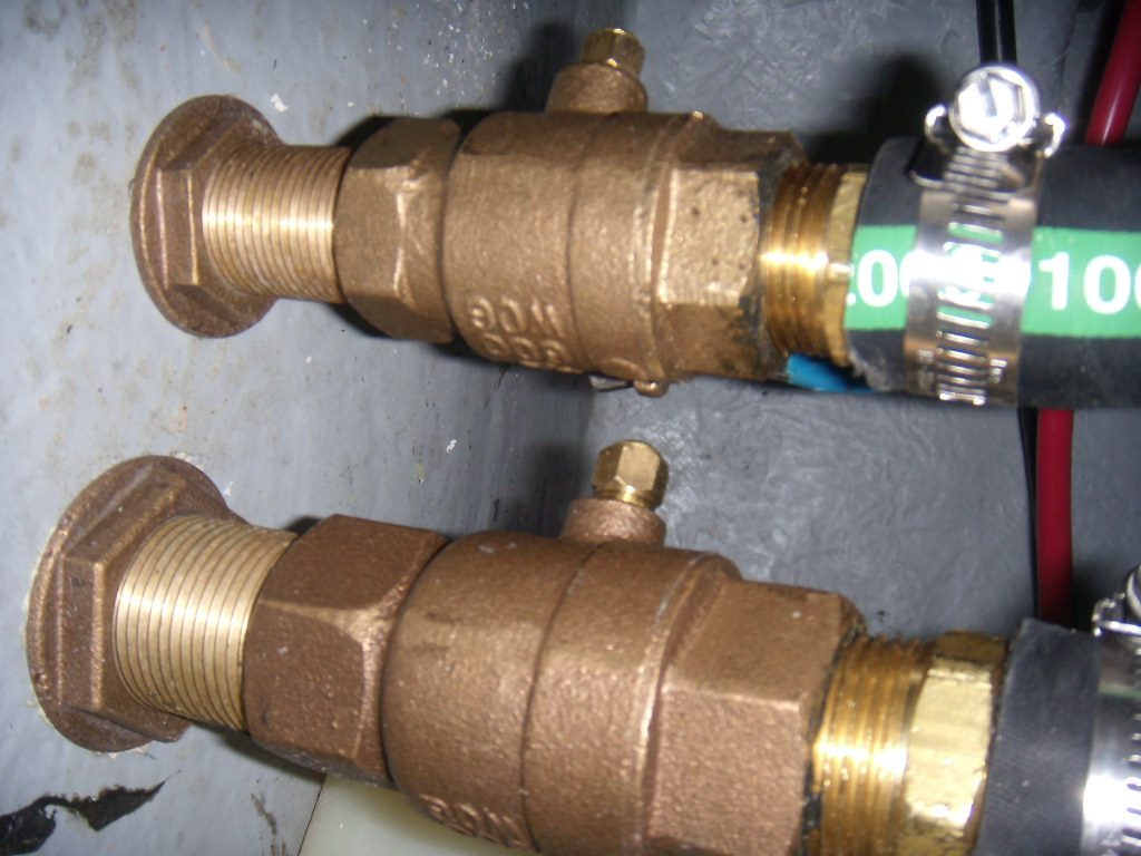

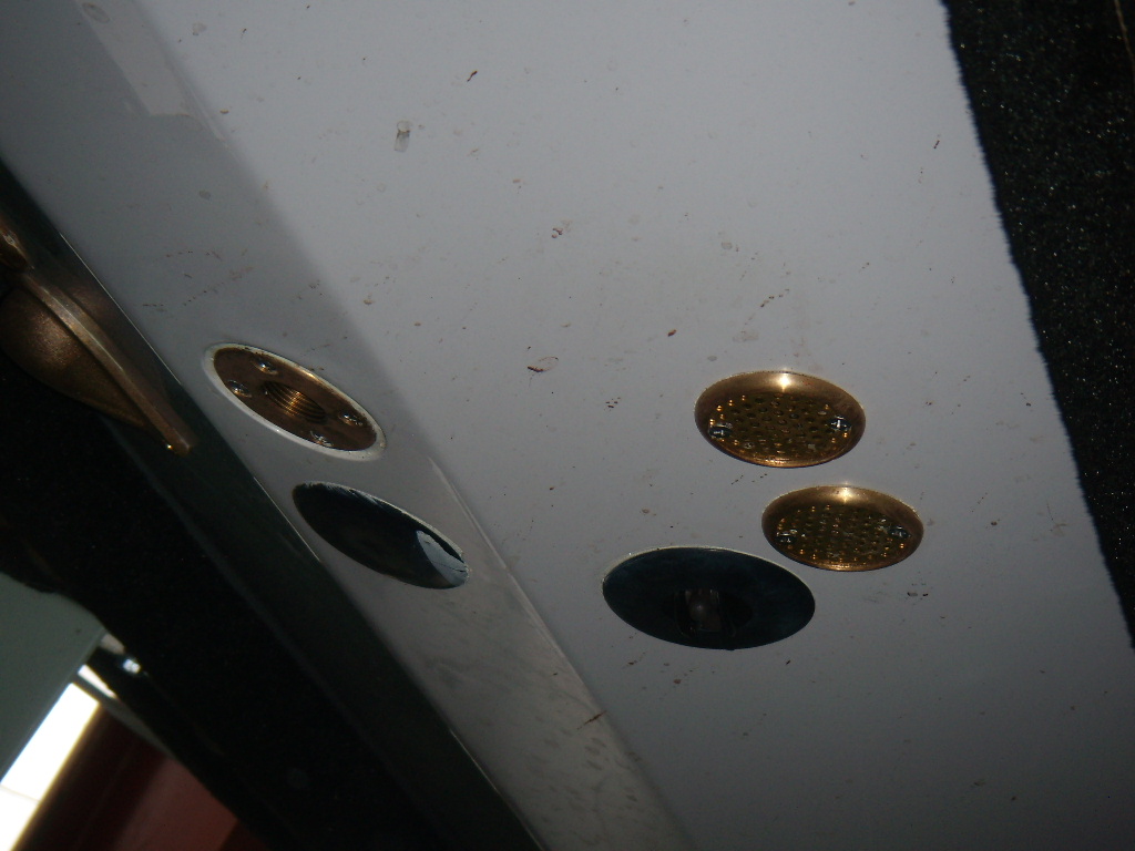

                            • bchesley
                              • Feb 2006
                              • 1252
                              • Tyler, Texas
                              Here are some pictures of how the new boats with the new style pumps are plumbed thru the hull.
