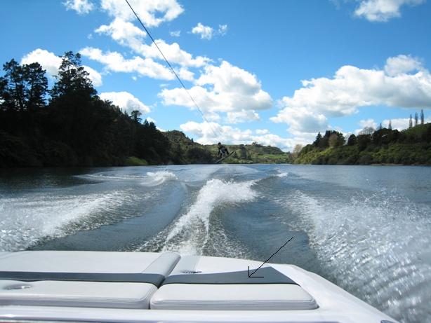

I was on one of the rear sun pads today gearing up for a board when I stood on what felt like a nail. It turned out to be the end of one of the screws attaching the hydraulic lifter to the underside of the hatch cover. It actually pierced the upholstery (see arrow) and drew blood. After a closer inspection of both hatch covers I found all four screws to be too long. Just a heads up to be aware you could experience the same problem. I have removed all four screws (2 each side) and will be replacing them with shorter ones.

I felt a jab in the foot a few weeks ago, but no obvious puncture in the upholstry - thanks for the heads up!
If you really get down to it you can find many "sloppy workmanship" areas on any Nautique. Sometimes you need to take some things apart or in this case just walk around. Either way they should look into some better Quality Control.2006 SANTE 210 (Pending Sale)
