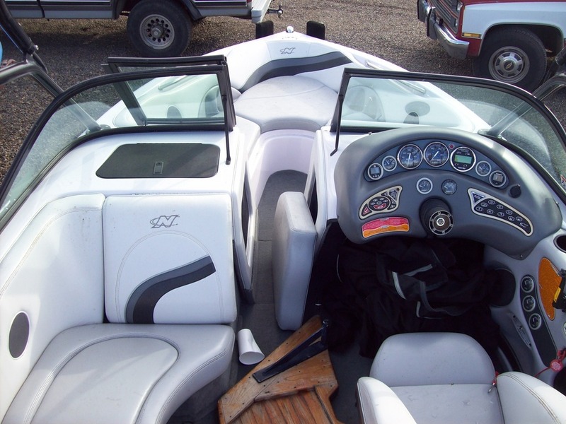

    What are these gauges?
    I am looking at a boat for sale and was wondering about the following gauges. There are two gauges just above where the steering wheel go that read empty and full. I am guessing they are for the ballast. But what about the gauges next to the driver's right leg ? I thought those were for the ballast. Any ideas what the gauges above the steering wheel are ? This is a 02 Super Air with the team stickers on it.

    The one's next to your leg "should" be ballast guages. Maybe the owner added extra aftermarket ballast to it...

      RE: What are these gauges?
      Can't really tell from the pix.
      As Bell said the gauges below the throttle should be the ballast gauges, should have labels Port, Belly, Starboard.
      Across the dash you could have, Oil Pressure, Battery Voltage, Temperature, Fuel Gauge, Depth gauge, Tach, Speedometer, Perfect Pass, clock, hourmeter (if not in the tach), etc.
      That would acccount for 4 fluid level gauges, but not 5.

        If I remember correctly, the gauges down by your leg are fuel level, volts, and I think they used to put a clock in there, but it dosen't look like you have a clock in that photo. The two above the steering wheel are ballast gauges for the factory tanks in back. On the dash you should have water/air temp and water depth (either ends), oil pressure, engine water temp, tach, speedo, and PP.
        This was the typical configuration before 3 tank ballast systems and combo air/water temp and depth gauges in the mid-90's.

          Most likely this is a 2002 Team Edition with 3 ballast tanks...
          The gauges down at driver side leg are the 3 ballast tanks level gauges.
          On your dash at the outher side are the water/air temp and the depth meter gauges (digital with display). The three big gauges in the middle are Perfect Pass (also digital display), tach (with hour meter) and speed. Next to the big three and between the digital temp and depth meter would be the engine water temp and fuel level.
          The two at the steering wheel would be oil presure and batery voltage.
          As far as I can see you're missing the analog clock and a bezel aroung the small gauge at the steering wheel...

            My 2001 SAN has the ballast on the panel next to your right leg and my buddies 2001 SAN has them like the pictures above. We always wondered why they were different. Did one of us buy a SS conversion, but we could never find any other differences even with the pump installs and wiring. CC must have had a day crew and an evening crew working different assembly process.
