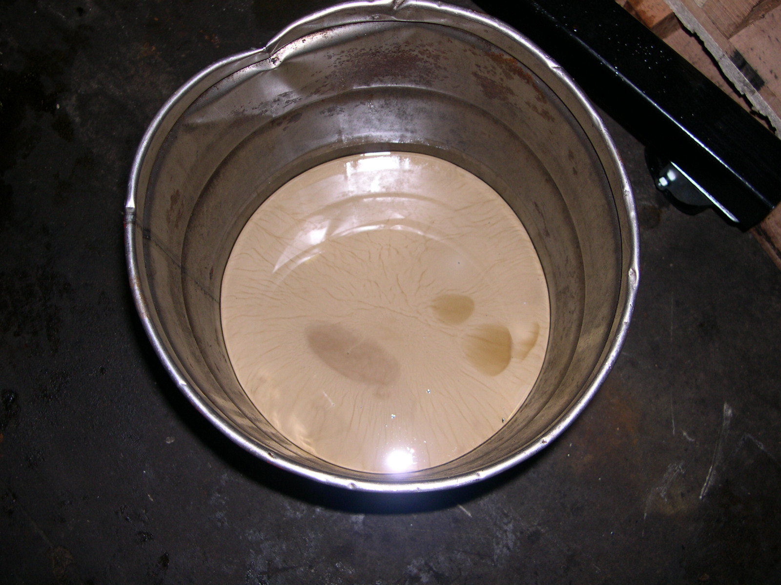

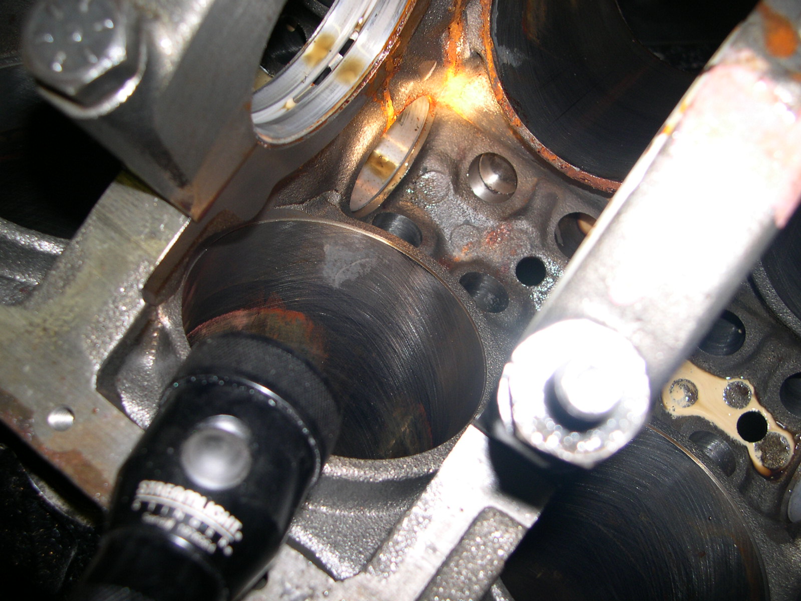

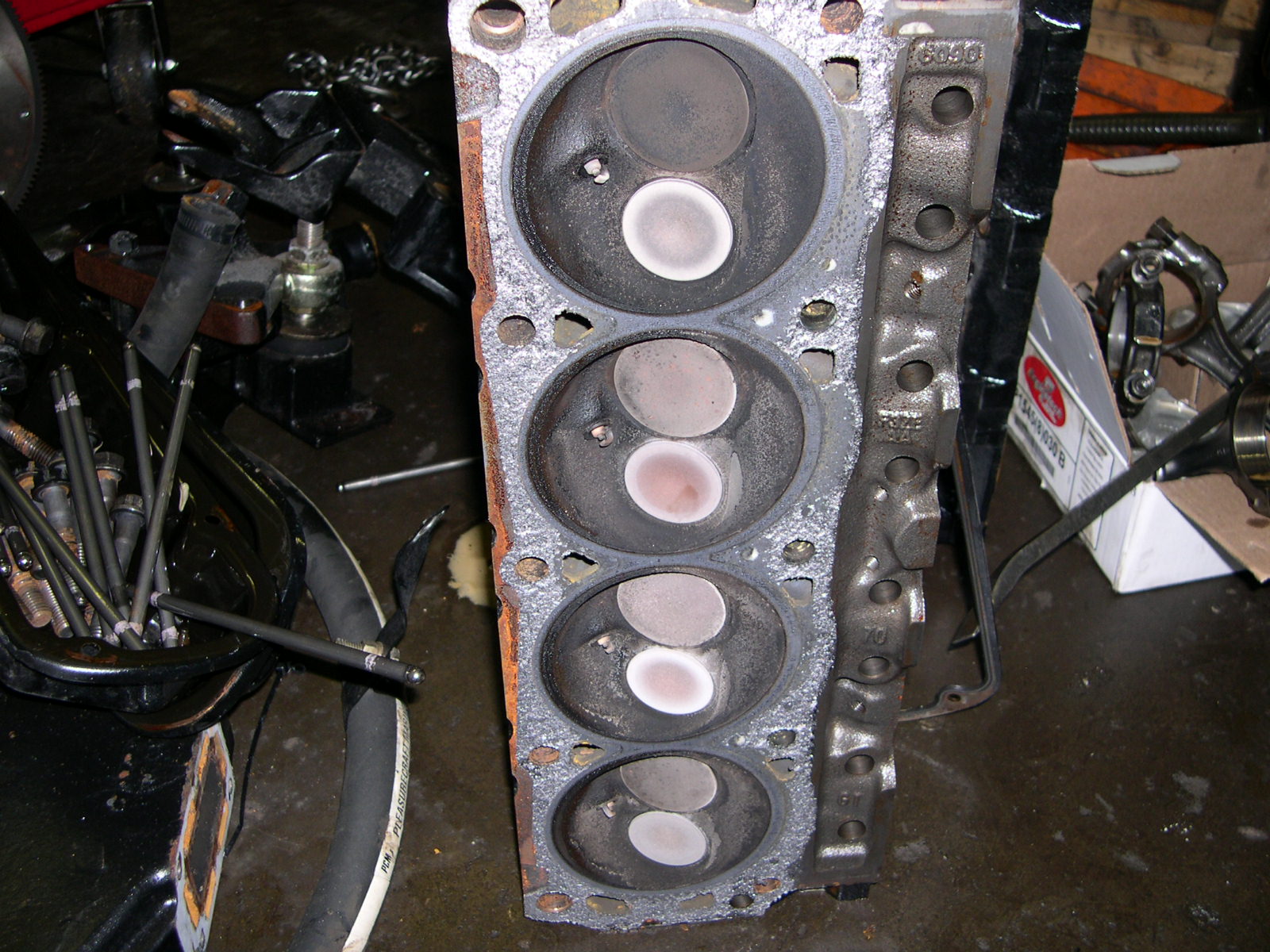

    Spring Project 2002 SANTE with cracked block
    This is my new project for the spring. I purchased a 02 SANTE from an auction with a cracked block, cracked intake manifold, and cracked exhaust manifolds. Here are some photos of what a cracked block and what milky oil looks like. I want to thank all of you who have posted your projects on this site, with photos. It has made me a lot more comfortable removing all the seats and side panels for a good cleaning while I have the engine out being rebuilt.

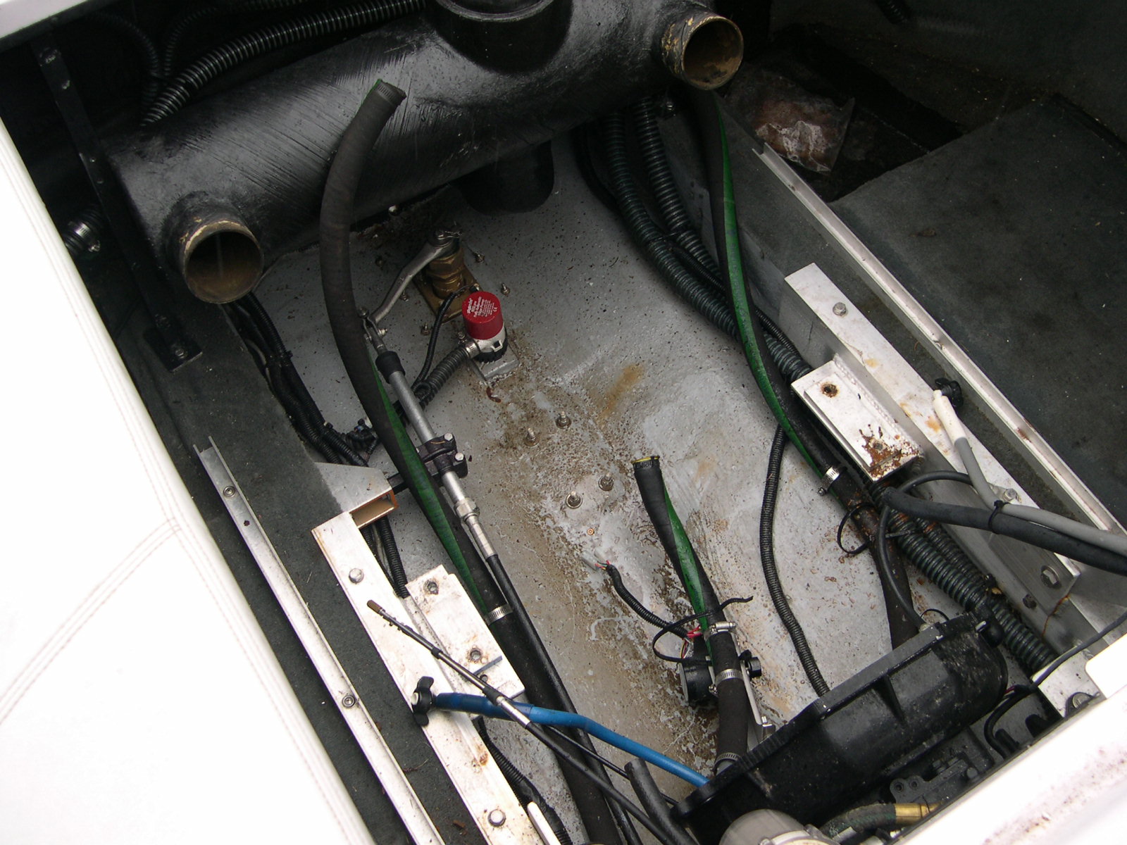

          How do you replace your rudder packing? There is no way to grease it. The boat only has 350 hours on it. Anything else you can think of replacing. I used Super Clean to clean the inside bilge area. I am not ready to replace the ballast system yet. The new engine is costly.

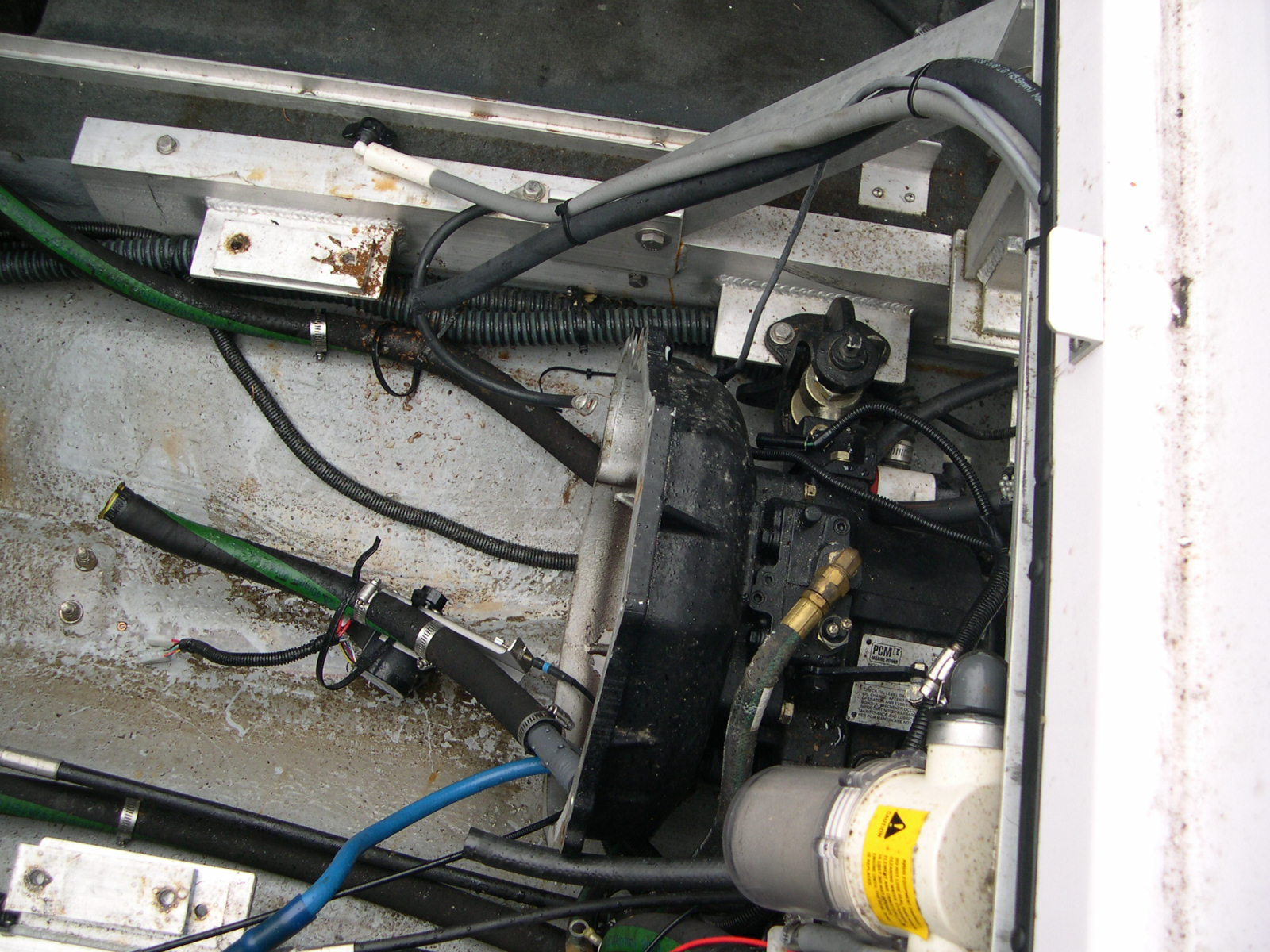

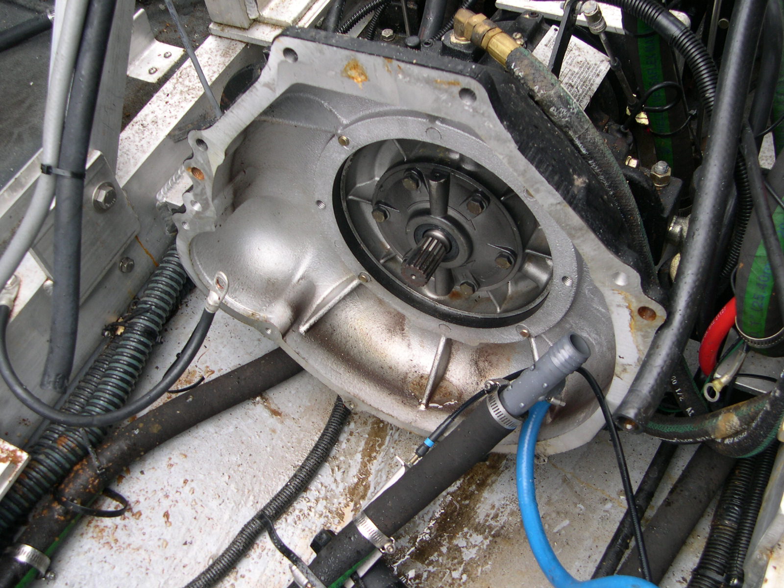

            Now would be a good time to do ballast work if you're planning on adding rear ballast. The stock ballast system on the 03/04 have the intake just foreward of the tranny and the ballast valves are just under the tranny and pumps rear of the engine on the port side. It's a rear pita to change the valves or to get the plumbing in there after the engines is back in there.
