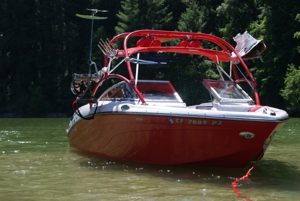

    We have a 2005 Super Air Nautique 226 with the flight control tower. The tubing is thinner than the new towers and it flexes like all ****. It is starting to crack our hull now from it shaking so bad when hitting other boat wakes and such. Anybody else had this problem??? We are thinking about just taking the tower off, re-glassing the mounting points and getting a newer Nautique tower on there instead. Any Suggestions from the community???? Here is a picture of the boat.

        It is happening on both sides in the rear mount of the tower. It does it whether the foil is on the tower or not, just a very flexible tower I guess. I will see if I can take some pics. Altogher, I would say we have maybe an extra 50 lbs with the foil, boards and speakers. A tower should be able to handle more than that. Anybody switched out their towers yet??
