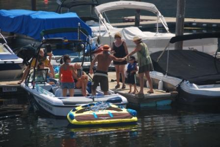

          Shooter: A crude but inexpensive solution that I am using is bungee cord. I use 2 four foot cords to strap a Blue lake and a knee board to the top of the tower. (Thanks to Mikeski for the idea.)
          http://www.planetnautique.com/index....light=vacation
