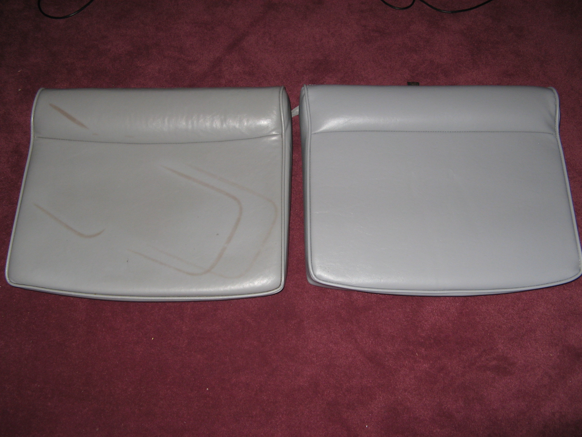

Mine is minor compared with an entire seat - the removedable seat cushion on the rear seat - 99 Sport. I am waiting for mine to arrive, just shipped yesterday.
