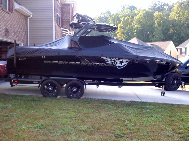

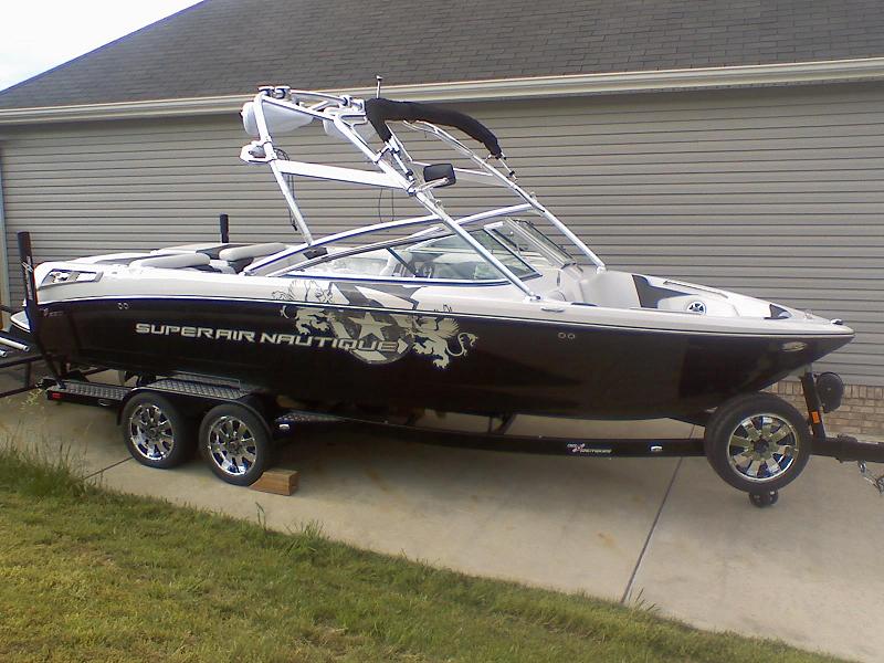

                  Call owen at www.boatmatetrailers.com
                  Tell him Tom from Chattwake recommended you. He'll take care of you and give you a great deal. They ship everywhere. Here are the trailers that they've done for me:
