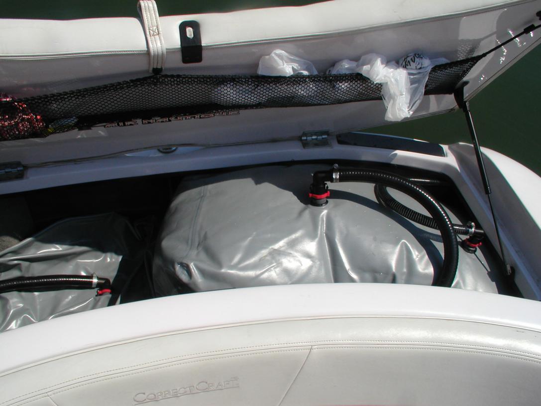

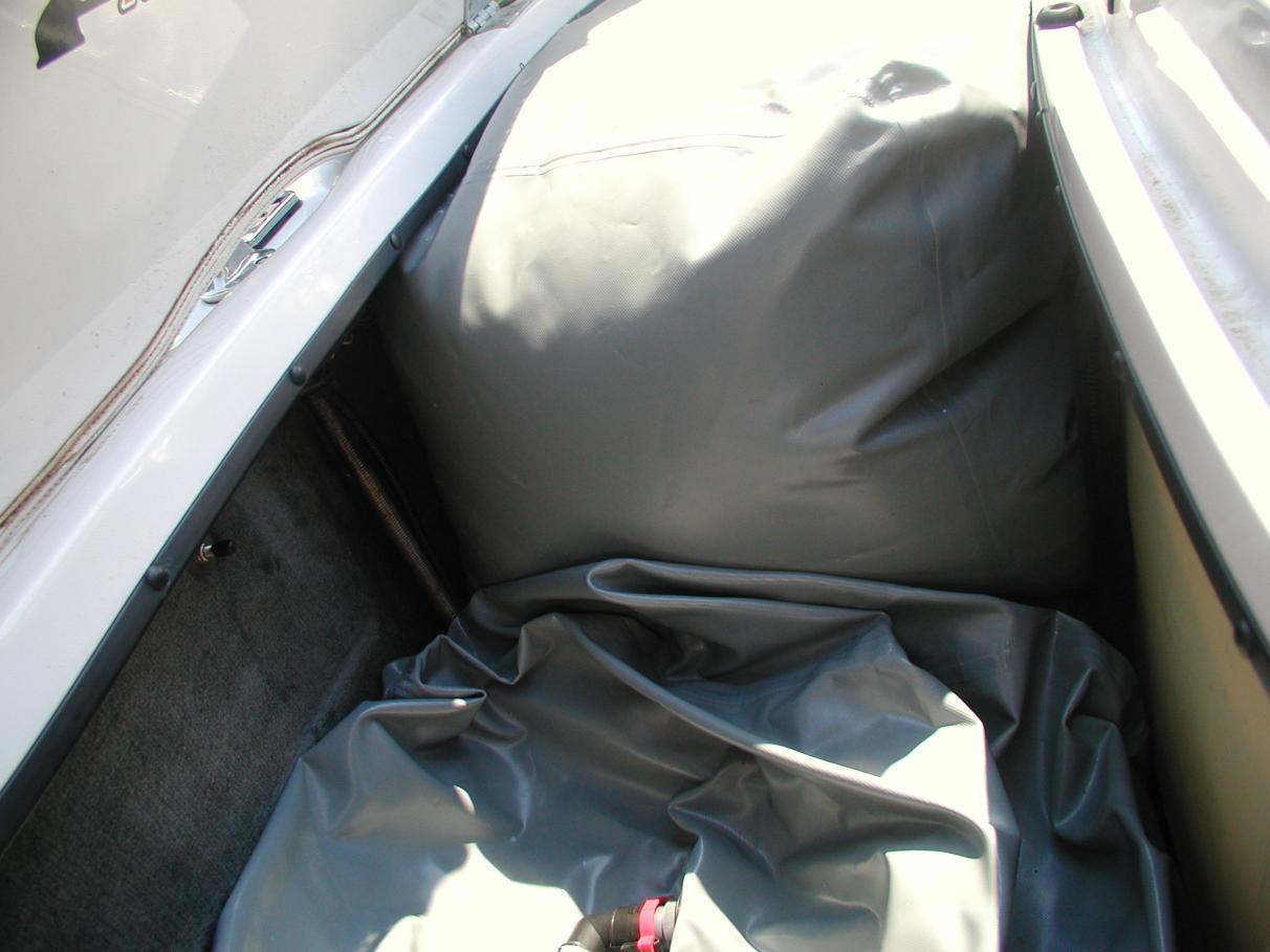

                    I'll try to post the pics again...first time on the new site posting pics!
                    Soo, if the pictures posted, you will see that I used two seperate bags in the trunk (I removed the stock plastic tanks), reason I did two bags was to have the ability to surf behind my boat (Pro Air hull), and we can surf with only a small crew, and a BIG board (Inland Surfer Red Tide), interestingly, we can surf either side on our boat. I also wanted to be able to adjust the weight from side to side with a small crew to balance the wake, again, this works pretty well.
                    The rear bags are the GG Supra bags, about 550 lbs or so. The ski locker sack was custom made to fit my locker, and I think that I'm getting ~550 pounds in that bag as well. I seem to remember that the size was 78" x 19" x ? (it's probably in the original thread "winter ballast project update." When we surf, we fill the ski locker sack and one of the rear bags, if we have a big crew, I'll fill both of the rears, and get my "mobile ballast" where I need them.
                    I don't have any extra weight in the front of the boat, except for a spare batter under the glove box, and junk under the bow cushions.
                    I'll see if I can dig up the wake pics too.

                          Miljack,
                          Thanks for the post, I saw your old thread and have been hoping to get your input...
                          I'm planning the GG bags in the trunk and rear seat sack in the locker, I am just trying to plan wiring and plumbing things (size of thru hulls, how to use factory thru hull, size of hose, etc) before pulling the trigger
                          I have a few questions:
                          1. did you use the stock thru hull?
                          2. I assume you used the stock vents for the hard tanks for the rear bags?
                          3. what did you use to vent the center bag? I am thinking of using the glove box drain (its a thru hull near the bilge...)
                          4. did you use aerators or reversibles?
                          5. is the boat still able to get out of the hole or does it feel overburdened? stock prop? what speed?
                          thanks for the pics!

                              WC, I replied to your Pm, sorry it took so long.
                              I use 6 aerator pumps to fill and drain my bags, if I had to do it over, would go with the Jabsco/Impeller pumps. My problem was the current draw, and packaging the pumps.
                              In my setup, I have increased the size of the stock through hull from 3/4" to 1 1/4", with a ball valve right behind it, and a RV "wastegate" to control the water flow to my manifold with the fill pumps. I built the manifold from PVC fittings and it sits under the front of my engine. I plumbed the fill side with 1-1/8" bilge hose, and the vents and drains with 3/4".
                              I used the stock rear vents for the rear bags, and I utilized the through hull on the driver's side from the OE fill system.
                              I think with the Jabsco's you will need to feed them with their own through hulls, but not sure about it.
                              My boat has a Python engine, so it doesn't matter how much weight is in it! :-) You do feel the difference when coming out of the hole, but on my boat, no probs!
