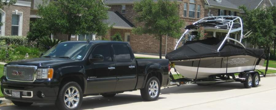

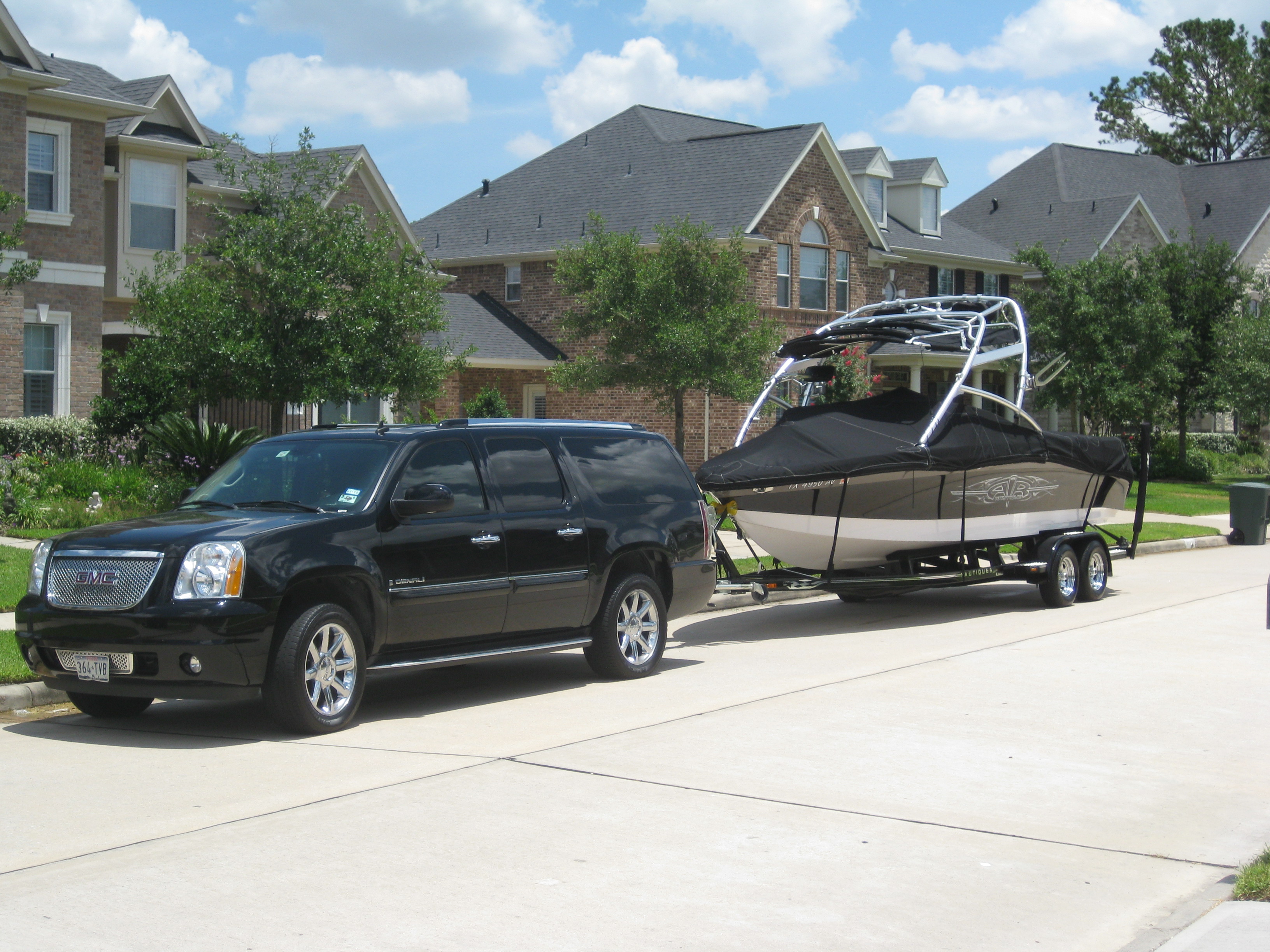

                Both my '07 and '09 Denali both run around double the outside air temp while towing. I too was concerned when I was seeing 200-210 trans temps in both trucks. I called GM and they assured me that this transmission is desinged to run hotter and as long as it does not get above 220, no worries. I have been all over the gm forum researching this very topic, and I think you may have an issue. I live in Houston and tow my boat to Austin all the time. I have never seen 240(Outside air 105+). I thought it was supposed to go into limp mode around 225-230? They make a external cooler that is much larger than the stock one that I hear people have great luck with.
                I have 55K on my yukon xl denali, of which 10K of that is towing the 236 around the country. No worries and gets about 12 while towing at 65mph. The engine in that truck is so powerful, I really feel you cant beat it. I have been in my buddies king ranch 250 and yes, super nice truck, but a little too much for me. The yukon xl-suburban-escalade esv chasis is so comfortable on the highway with kids and gear.
                I will say that my yukon xl denali pulls and rides better than my sierra denali. I would attribute most of that to the adjustable ari suspension in the yukon xl.
