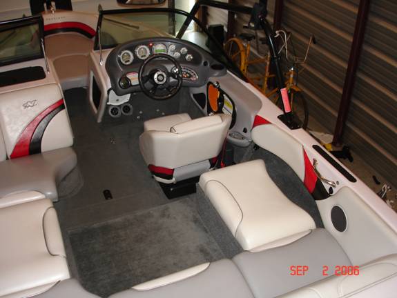

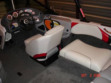

Here's what I did on my '03. It turned out great.
Here's the thread...
http://planetnautique.com/vb3/showth...around-seating!I own and operate Silver Cove Marine, which is an inboard boat restoration, service, and sales facility located in Mooresville, North Carolina. We specializes in Nautiques and Correct Crafts, and also provide general service for Nautiques fifteen years old and older.
Chexi, I have a jump seat and never really use it. I want to install a "wrap around" seat like in Jeff's post.
Thanks Jeff! I have seen that post and based my plans off of it. I have the carpet and plan on duplicating my cooler cushion for the seat. I don’t plan on installing a sub and I will just use the space for storage. What do you think about using King Starboard instead of plywood for the box? I was even thinking about making it out of fiberglass like the other seats. I'm afraid the plywood may rot over time.
You could use HDPE for the base. I built a jump seat out of plywood and carpeted it. No troubles. Just heavy. For the contoured portions, I stacked styrofoam insulation and wrapped in duck tape. Glued to the base, then carpeted. Supported plenty of weight. Hinged the seat and put nonskid underneath it so I could fold the seat out and use it as a stepover to get to the bow. Hinged the seatback so that I could store things under the seat. Used OEM skins and worked backwards. Cupholders were an afterthought, but are pretty easy to add.
Not sure if you can find the write up online these days, but the project was written up in one of the Summer 2005 issues of Water Ski Magazine. My old boat. So not a CC, but you get the idea.
