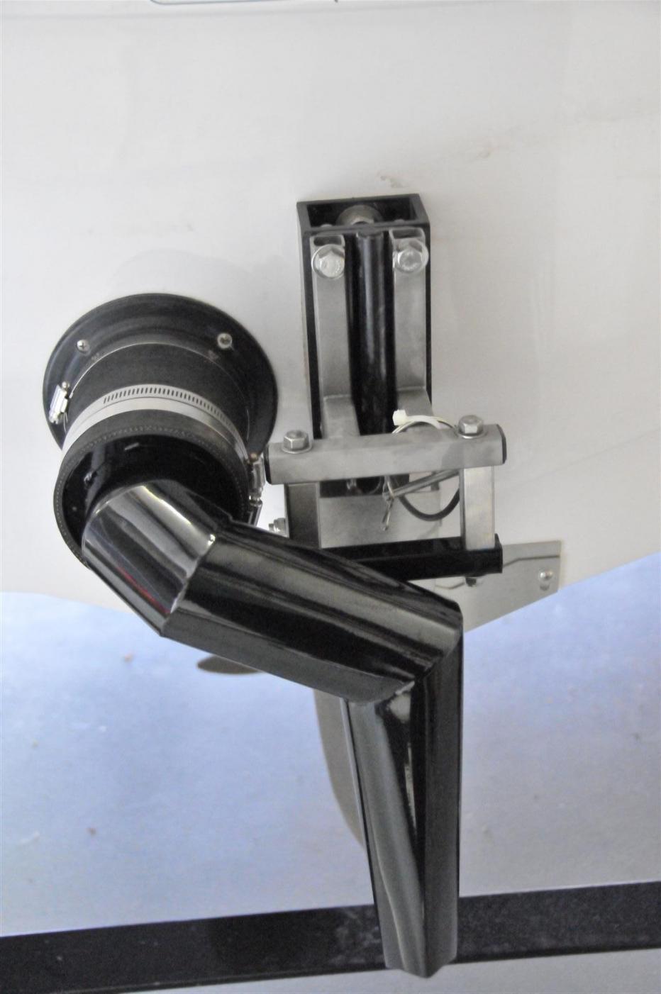

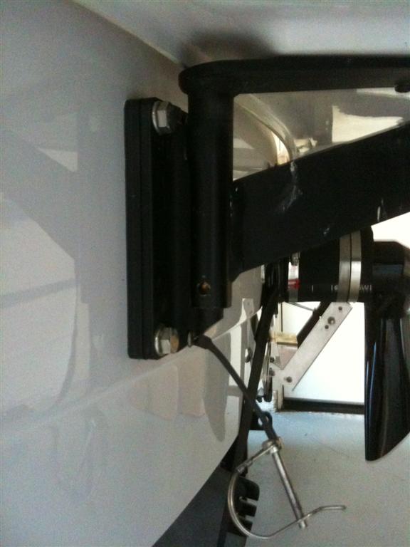

                Here are some photos that show the issue...
                The first picture shows the platform in place (but w/o the pin inserted so you can see the hole for the pin...it is aligned perfectly and the pin simply slides through the hole shown).
                The second picture is when I lift on the rear of the platform. As you can see, the female portion of the bottom of the bracket swings away from the male portion. The pin clearly provides the structure to hold the bottom portion of the bracket in place horizontally as well as vertically (...in fact, the bracket moves enough that you can see the aft side of the male portion of the bracket through the hole for the pin).
                The third photo shows the FAE bracket on the center swim platform bracket. The hole for the retaining pin is approximately where the horizontal aft-facing arm is located on the FAE bracket.
                So, this is what I'm talking about...
