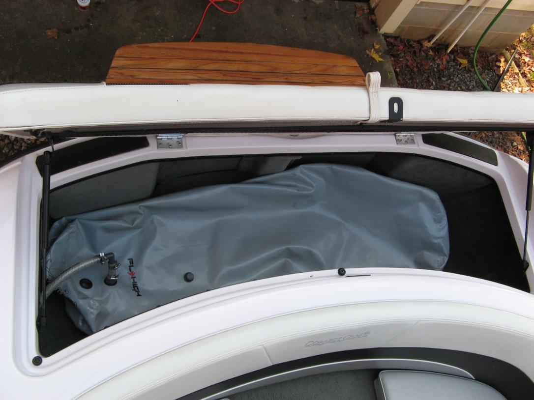

    I don't have access to my boat at the moment, and was wondering if someone could give me the dimensions of the rear ski locker in a 98 Air Nautique (or something comparable).
    Trying to see if this fat sac would fit: http://www.wakemakers.com/fly-high-rear-seat-sac.html
    Fat Sac: 62" x 26" x 12"
    I know I don't have to fill the fat sac all the way up, but I was hoping to get all 580 lbs out of it.
    Thanks!

    in my 99 Sport, I had the "Tube" sac which is 62x16x10 (370lbs) vs 62x26x12 (580lbs). The length of 62 is good, the problem is the compartment is only 17 inches wide. I was not able to find a standard sac with more weight that fit. The perfect would be 16 inches wide and more height

      I guess I'll need to go with the tube sac for now. Maybe throw in a couple sandbags for the short term.
      Thanks mcbridek!

        I have heard (on this site) that you can have them custom make a bag - you can give them the dimensions of the locker. You might want to see how much this costs. It is worth looking into. If i was to do it again, I would want more weight - I like the 580. Try this WEB site - it has all the bags sizes and talks about customer ordering
        http://home.comcast.net/~lreinsma/
        http://home.comcast.net/~lreinsma/custom.htm
