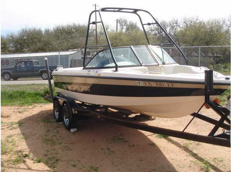

              Anyone have a pic of "the original Flight Control Tower" they could post?

                Husky, just search for 98 Air Nautique and you will find pictures of the first gen FCT all over the place. Here is a link to one. http://www.boatsville.com/used_boats...m?boatid=43164
                  There are a bunch in the '99 brochure on correctcraftfan.com. Here is one from that brochure on a SAN...
                  http://www.correctcraftfan.com/refer...ex.asp?page=16
                  Click through the other pages of the Air/SAN to see more. There are also a couple in the '98 brochure.

                      My 1999 Nautique Super Sport has the FCT1. So far, no cracks and it is fairly solid. Only over large waves that hit hard does the thing make noise/rattle.
