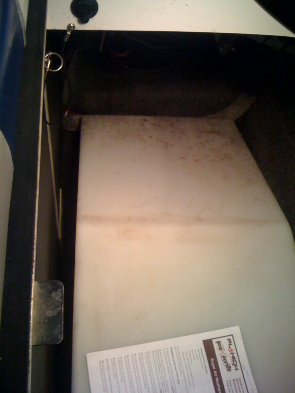

    i have a 2009 SANTE and i ordered the fly high v drive sacs. when i pulled the carpet boards up from the boat i noticed that the hard tanks in my SAN have a downward slope on the front of the tanks. am i supposed to use the rectangular v drive sacs from fly high or the wedge sacs?

    heres a pic of my starboard tankfacing the bow.

      Im not 100% on this, but I think you need the wedge sacks.

        You could use them but that would not be the route I would go. Go with what holds more water. The wedge sacs are like a cheese block. The tanks that they fit with look exactly the same so that when you put the sacs on top it becomes a rectangle.
