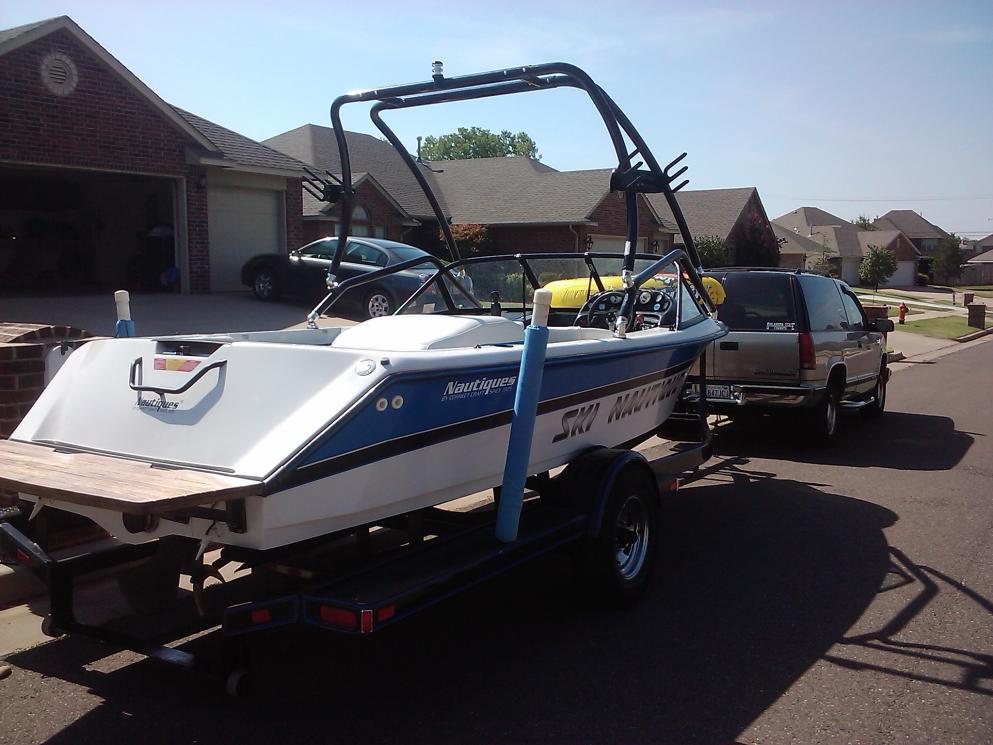

    Here is a pic of our boat!
Name:	2011-07-16 10.37.54.jpg

        Not to hijack, but how do you like your tower? Looks great. Do you have a good side shot? Thinking of putting one on my 93 Sport. Thanks.

          What brand is that tower? It is not the one I thought and I like yours better than the one I have been looking at.

            Laddski, thanks! I like the tower and think it looks great on this boat. It is the aerial tower, and folds down in about 2 minutes so I can put it in the garage.
