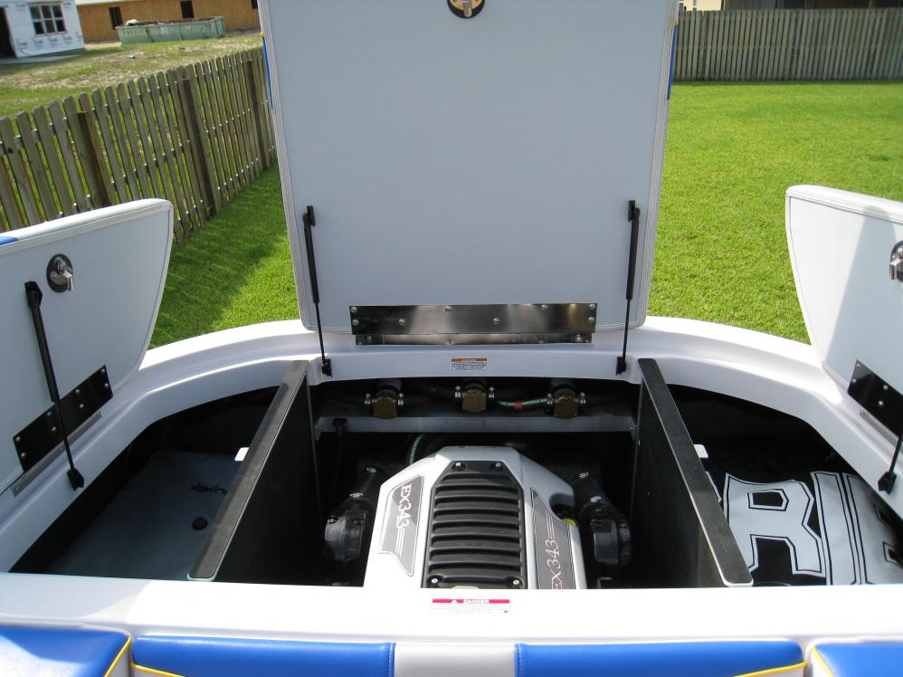

    3.) What kind of weight can you fit in the rear lockers? I've heard a 750# sac will fit, but does it fill up completely (or close)? Is it worth it to take out the factory tank? How good does an enzo sac fit (fills up completely without extra space). Can anyone give me dimensions of the locker with and/or without the factory tanks?
    The 750's will not fill completely unless you remove the factory tanks. The 400's will fill completely on top of the factory tanks. (i want to upgrade to these from my wedge sacs. The enzo sac will fit in either side locker, but i don't know if the large part will fill completely (no experience with that one)

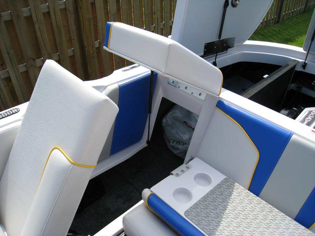

    4.) What kind of storage is there under the rear side seats? Are the under seat compartments equally sized on the port and starboard? Basically, if I put a sac in each and filled it to the max, will there be equal weight in each side or will I have to adjust? Does anyone have dimensions and/or pictures?
    Sorry I don't have the dimensions of the rear lockers or under seats, but I do know that they are the same on both sides. From the battery's to the stern, the compartments are completely equal and we never have an issue with uneven weighting with everything full

    Here are the only pictures I have of the rear storage.
