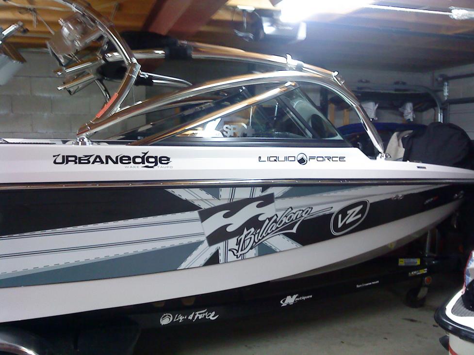

        The timing of your question is impeccable Check out this thread I started a few days ago. Mine is the 1st boat with the FCT-2 Titan tower. I have 4 tower mount speakers and it is is still pretty easy to fold down. The garage door height is 7'. I suspend the tower from the garage roof to take the tower weight of the windscreen.
        http://www.planetnautique.com/vb3/sh...er-down-thread.
        • super01
          • Jun 2009
          • 277
          • 2008 Super Air 230 2001 Super Air 210 (Sold)
          Good pictures Bevan. That's pretty cool, wow that is just barely squeezing in there isn't it! But I can really see how the tower works now, thanks.
