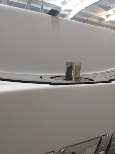

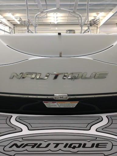

                  Hey folks,
                  Digging up an old post to continue on this topic. Considering some of the mid-2000 SAN boats have no lower pylon, that leaves the only option to tow from the lifting ring for a low tow point for cases where you don't want to tow from the tower (ie: a bunch of 5 year olds on a tube - yeah, save your comments about tubes). Anyone else install a pop-up pylon/lifting ring kit to replace the basic lifting ring? How did that work.
                  Attached are two photos showing the ring. Yes, people use this for towing I understand, but I also understand it is not ideal so I am wondering if it is an easy swap out for this part:
                  Item NO. 90093 PYLON COMBO LIFT/TOW POP-UP
                  from Nautique parts.
                  Thanks for your thoughts.
