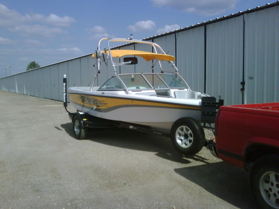

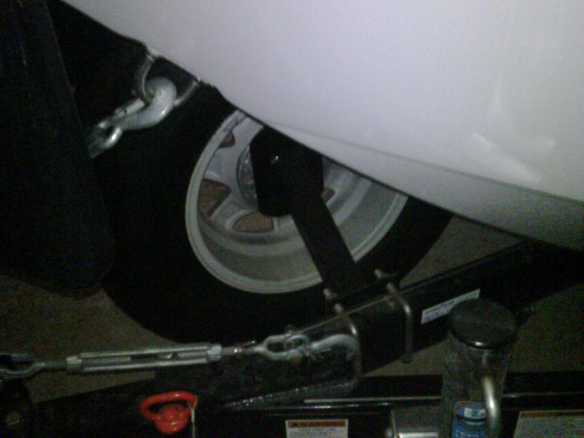

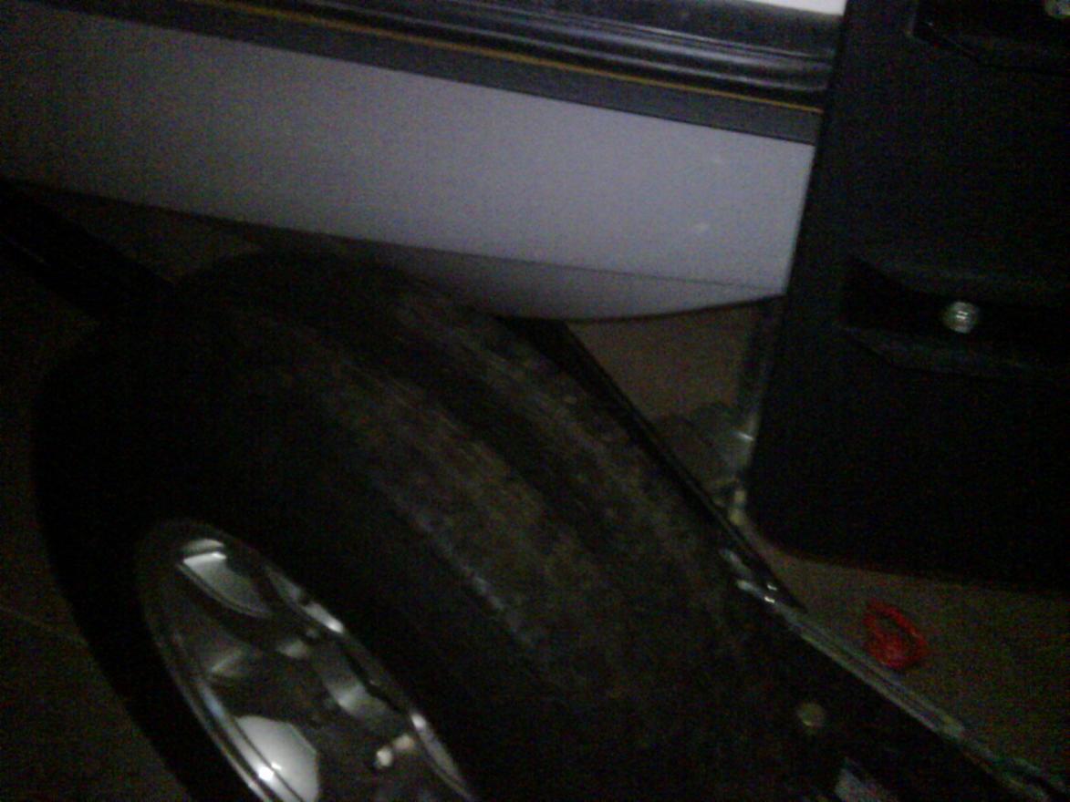

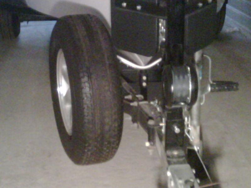

          They do usually respond to technical email questions and can tell you exactly what to order....then you find a dealer to handle if for you. I did this for a different part. You could easily handle the transaction through nautiqueparts.com and the part drop ships to you from Ramlin.

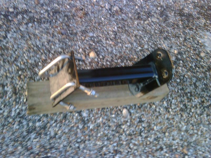

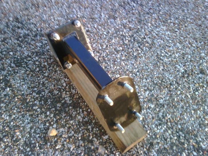

          On the mount, I have an extra mount I bought with my new trailer (bought two spares for the 1000 mile trip and the loose one came with the bracket). I've considered selling it and still have no idea why I would need to keep it...but I've kept it.
          For location, there is only one really...especially if you have the swing tongue.
          If I really pulled the boat long distances like some of you guys do, Ideally I would:
          Not have the swing tongue
          Mount the jack forward of the stop pad/winch
          Mount two spares, one on each side similar to the one shown in the pic. See all my pics from the last time this topic came up.

            I use the same spare mount as shown here. Works great, except on really steep launch ramps, the tire can hit the rub rail on my super air. Otherwise it works perfect.

              I've always wondered if there was a scenario where it would hit.
              Also note it inhibits the tongue to swing around (to some extent).
              It might also inhibit sharp turns/backing but I've never had a problem. If i do need to go extra sharp...I try to favor the other side.
              One other note. It is very strong....you can set the boat down on the tire w/o using the jack. (Don't ask how I know this.)

                Airtool, I've also considered for some adding a mount, IF you wanted to part w/ your extra, what would you want shipped to God's Country up here in the PNW? My DHM trailer is 2" x 4" frame, looks the same as your Ramlin.
