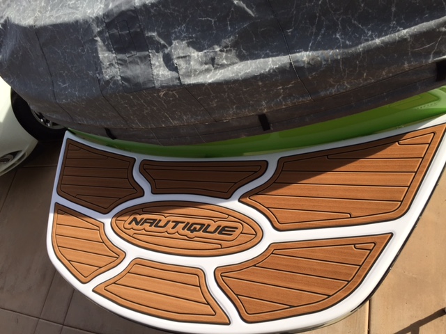

                    Use Acetone to remove then old SeaDek. It is a huge PITA! Comes off easiest when it sits in the sun for an hour.
                    I ordered my SeaDek from Nautiqueparts.com If you want something custom, you will need to order the seaDek kit directly from them. You can always tell them it is for a custom boat..no brand name.
                    Here is my swim platform...doing the whole boat in the next couple weeks...
