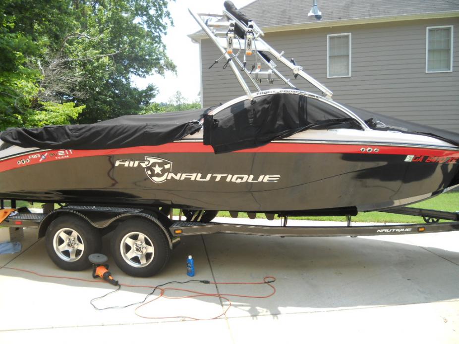

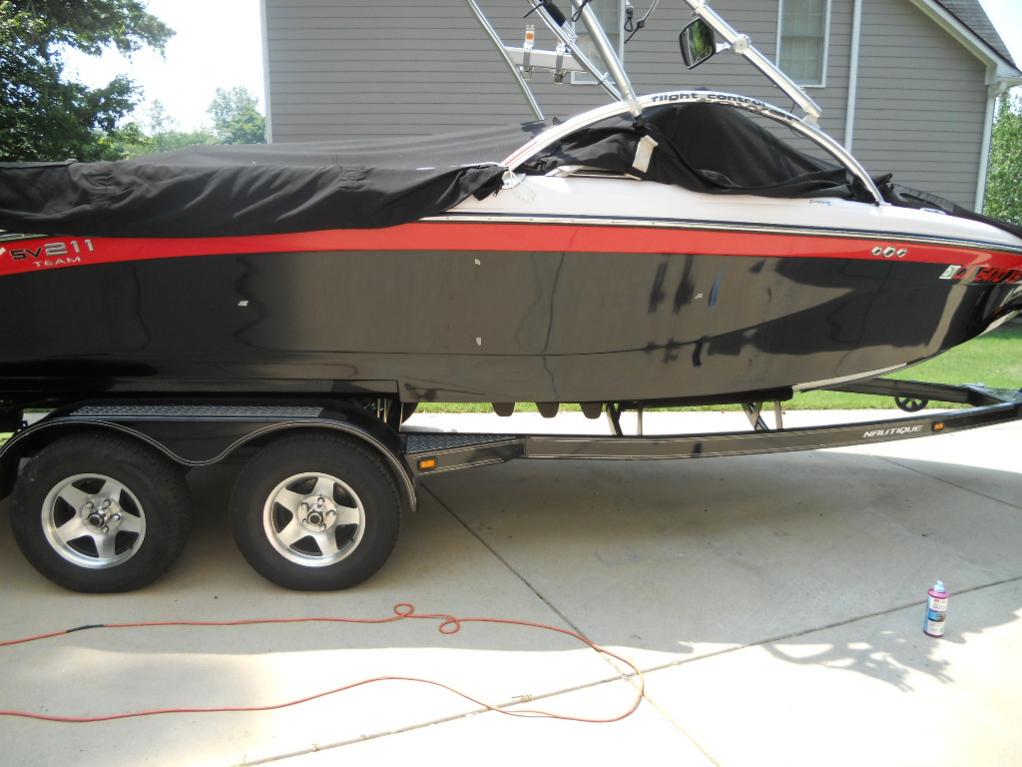

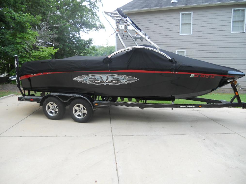

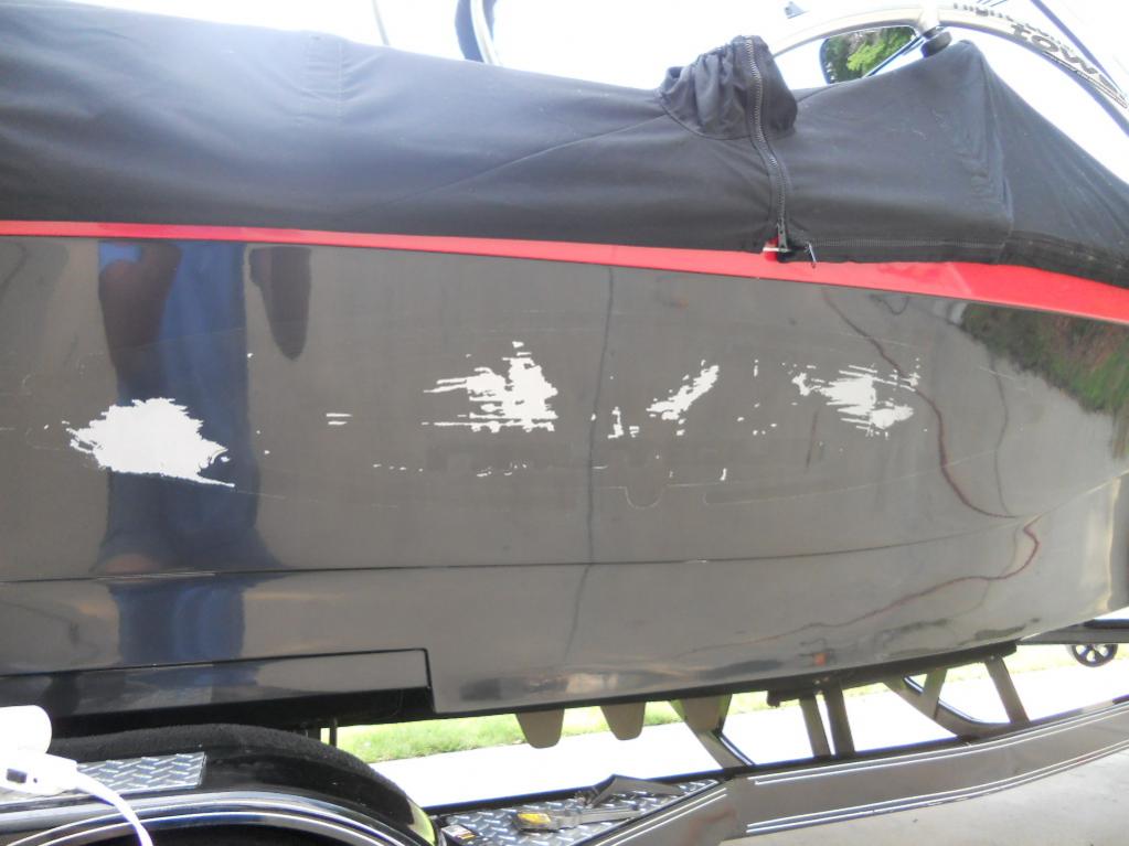

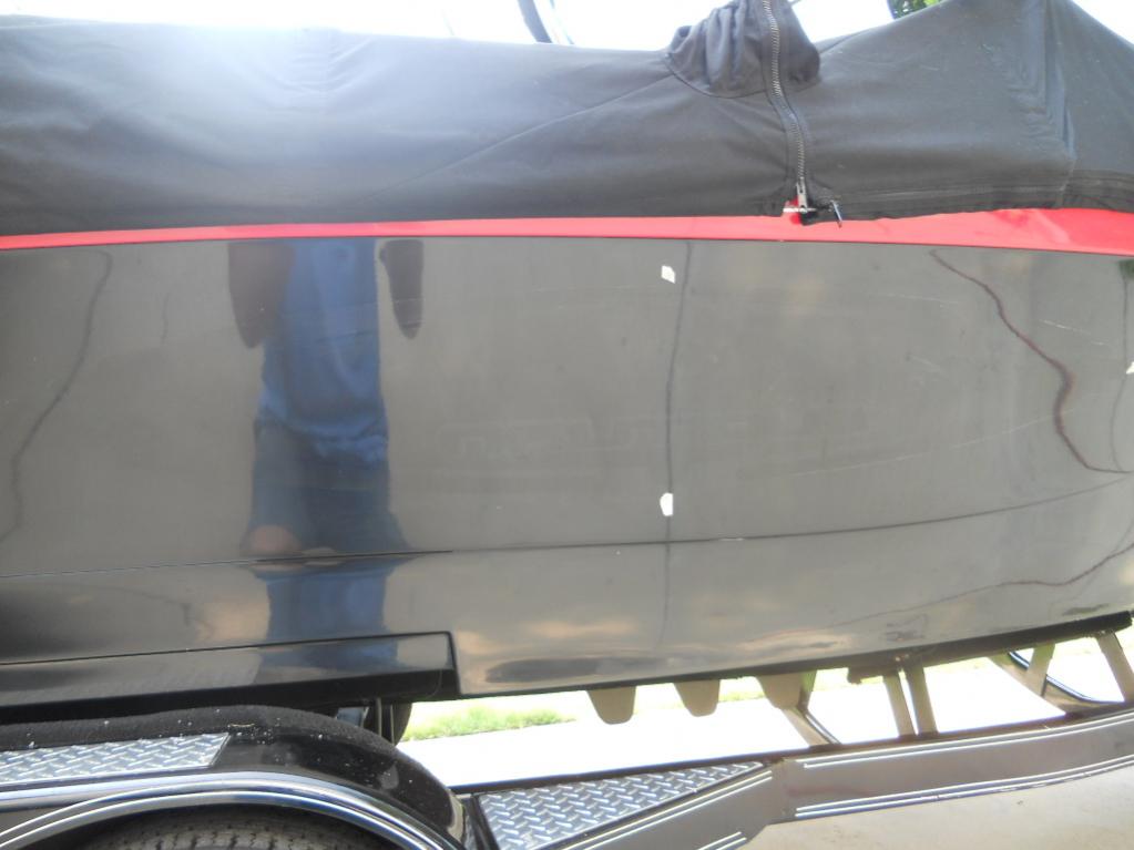

ID:	363310I did this just last year. I'm pretty OCD about the appearance of my boat and while it did take me a lot of checking and rechecking before I got the nerve to remove the backing and actually adhere the new decals to the hull - it was well worth the time. The removal of the old logo is the most labor intensive part. I used masking tape to mark the center of my old decal before removing it, then peeled most of it off with the help of a hair dryer. Mineral spirits removed the remaining residue, followed by buffing with 3M Perfect-It Rubbing Compound.
                    It took probably two hours per side to remove and buff. Followed by an hour of measuring-taping-stepping back-looking...measuring-taping-stepping back....you get the idea. (and yes I did get the new logo from White Lake - they simply had them drop shipped from the factory)

                        MikeC - that thing looked pretty redic naked!
