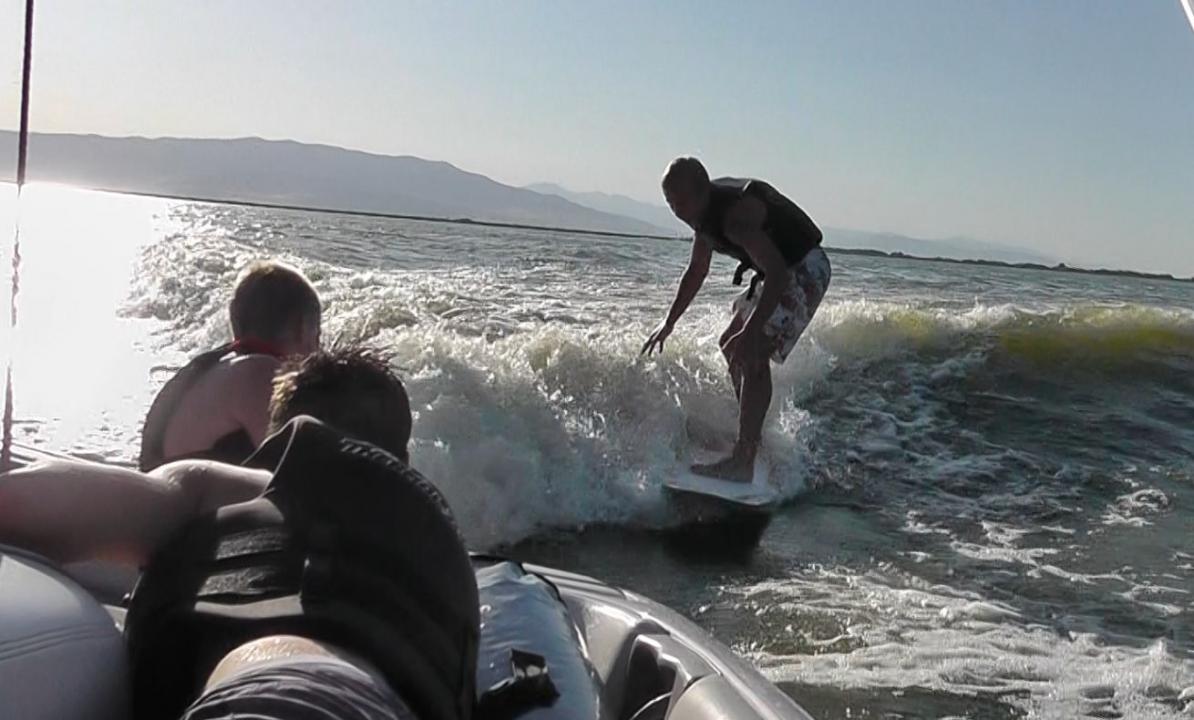

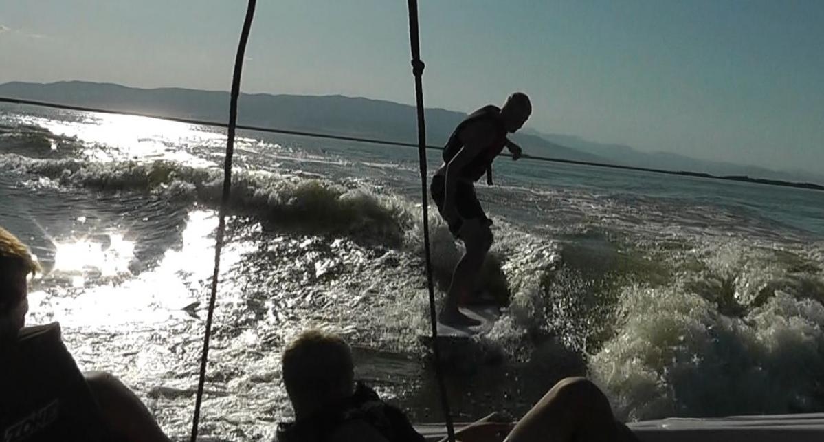

                1. No, I did fill up the #200 tank but it didn't seem to do much. Replacing this solution with a ~#400 bag from flyhigh. The main reason for this was to get all the extra storage space when not using ballast. I am really hoping that I can get a picture of someone with a 206 without the ballast tank in there so I can figure out how the floor is done so I can make a piece for the bottom I do think the extra weight further back will help.
                2. We have people surfing both sides. We simply shift all the people from one side to the other depending on who is surfing. We have found that putting the boat into a slow turn towards the side that they are surfing helps clean up the wake. If we only have a couple people then we fill another #350 tube sack to about #300 and then flip it from one side to the other depending on the person surfing. The starboard side is cleaner due to the prop rotation but both sides work fine.
                3. Water is still below the vents in the back. We haven't pushed it that far yet.
                I experimented a little with putting a #350 bag in the front. It ended up taking down the size of the wake and making it longer. I am guessing that would only work with a bunch more weight in the back. I am sure that with more weight we could get it quite a bit bigger but for the kids to mess around it has been plenty.
                Biggest wake we got was with #700 in back and (2) #350's stacked on one side with 3- 150lb people on that side. Was really nice but everytime we stopped we had to have the people jump to the other side to keep from taking some water in. Was a big dicey for my taste so we went with the single bag on the side.
                Here are some pics with the #700 sac, (1) #300 and 2 kids that weigh about 150lbs. Works great for when we do it.

                        dski-
                        You will get a bigger wave if you goto deeper water. 15+ feet. UT lake on a good day out in the middle is only 11 at best. Most of the lake is 8-9. Try Deercreek. You will notice a big diff. Just sayin.

                          Capt, you are very right! As you say, the wake that the boat creates is much better with deeper water. In fact, that is close to the entrance to mud lake where we only had 5-7ft of water most of the time.
                          We ski the course at Utah Lake and just do some surfing every once and a while when we are done. It is not the main activity, just something we mess around with.
