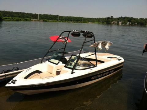

        Ya sorry that pic is terrible, I will get some better ones up this weekend once I get it buffed out and waxed. That was the only one I had on my phone but I may have a couple of it in the water when we were down in SC. Either way there will be some better ones of her posted soon.

                      I still haven't messed with the prop on my boat yet but resurrecting this post reminded me that I should put a better picture of my boat on this thread now that it's cleaned up.

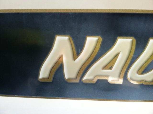

                      Before (pretty sure the previous owner hadn't waxed in a few years...

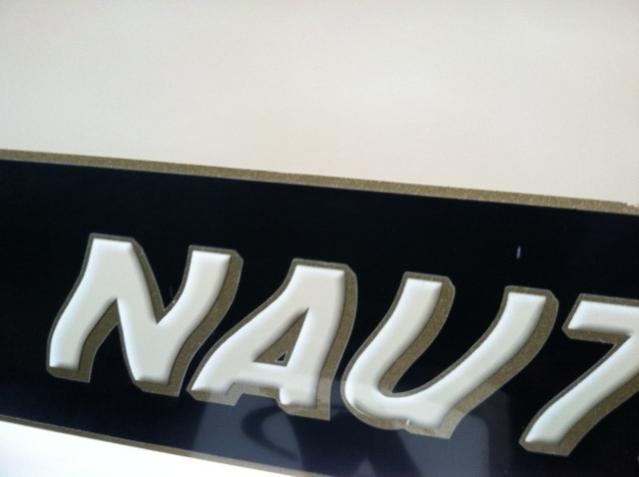

                      After hours of buffing using star bright heavy cut compound on the black, then medium cut on everything, then polish and Fleet Wax:
