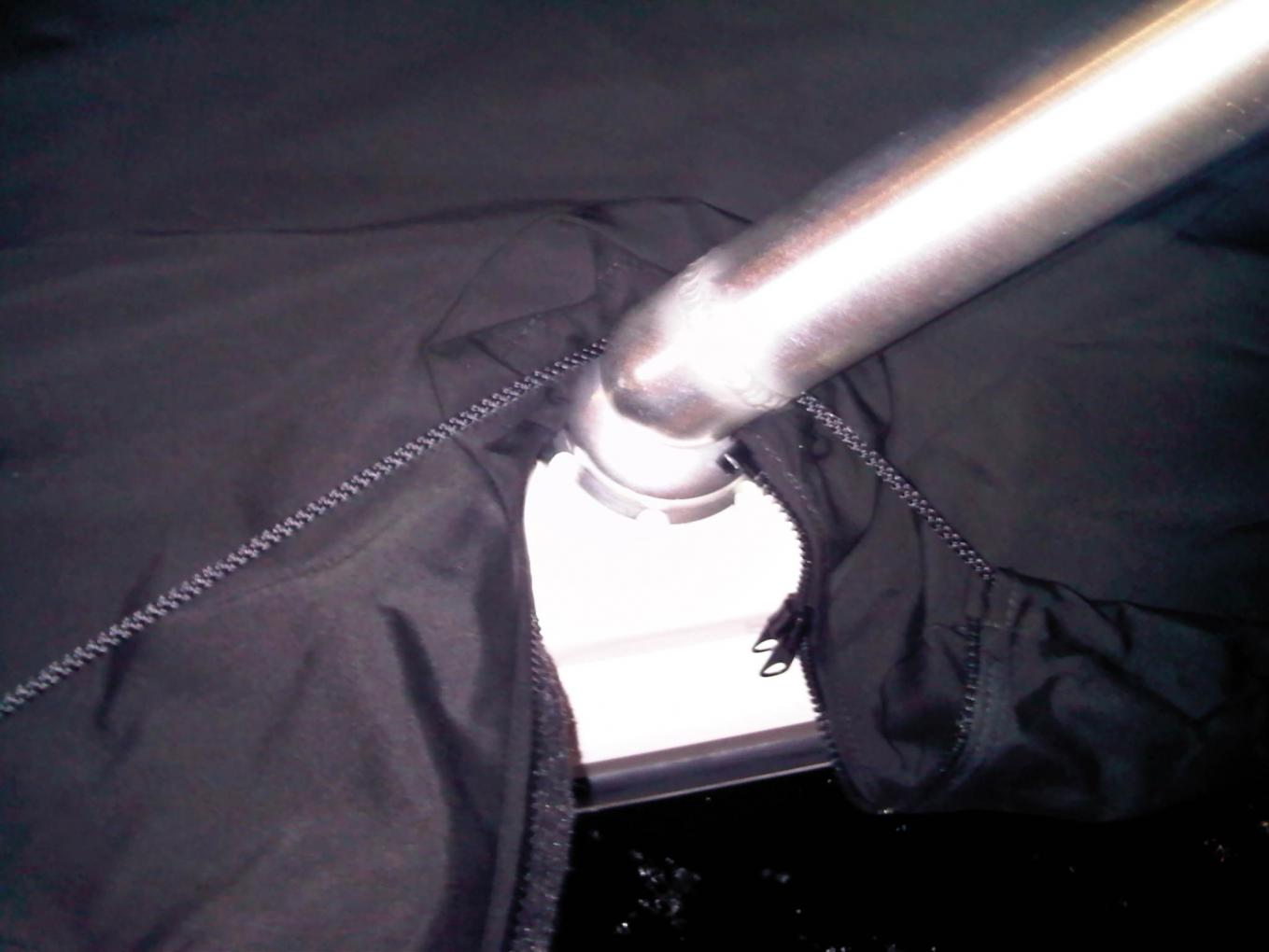

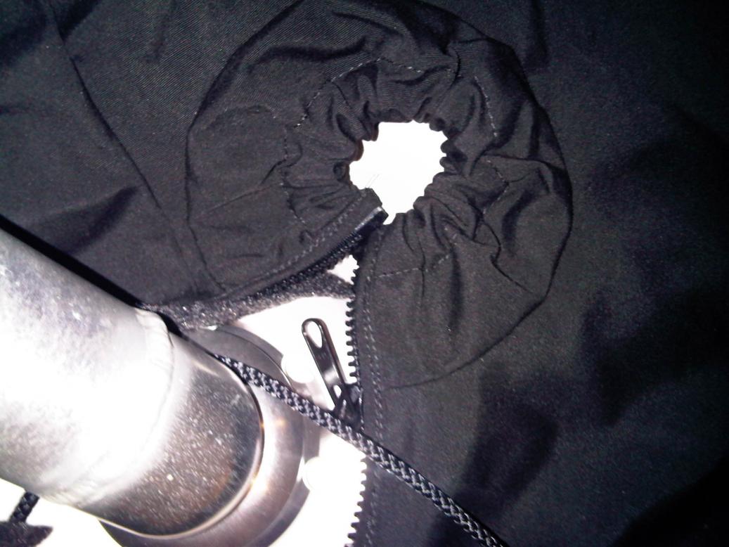

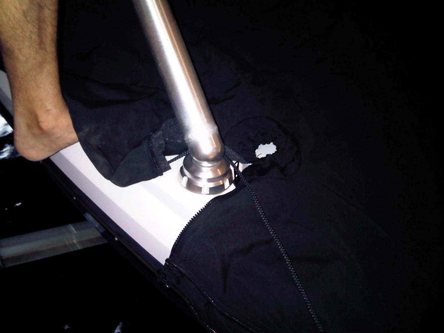

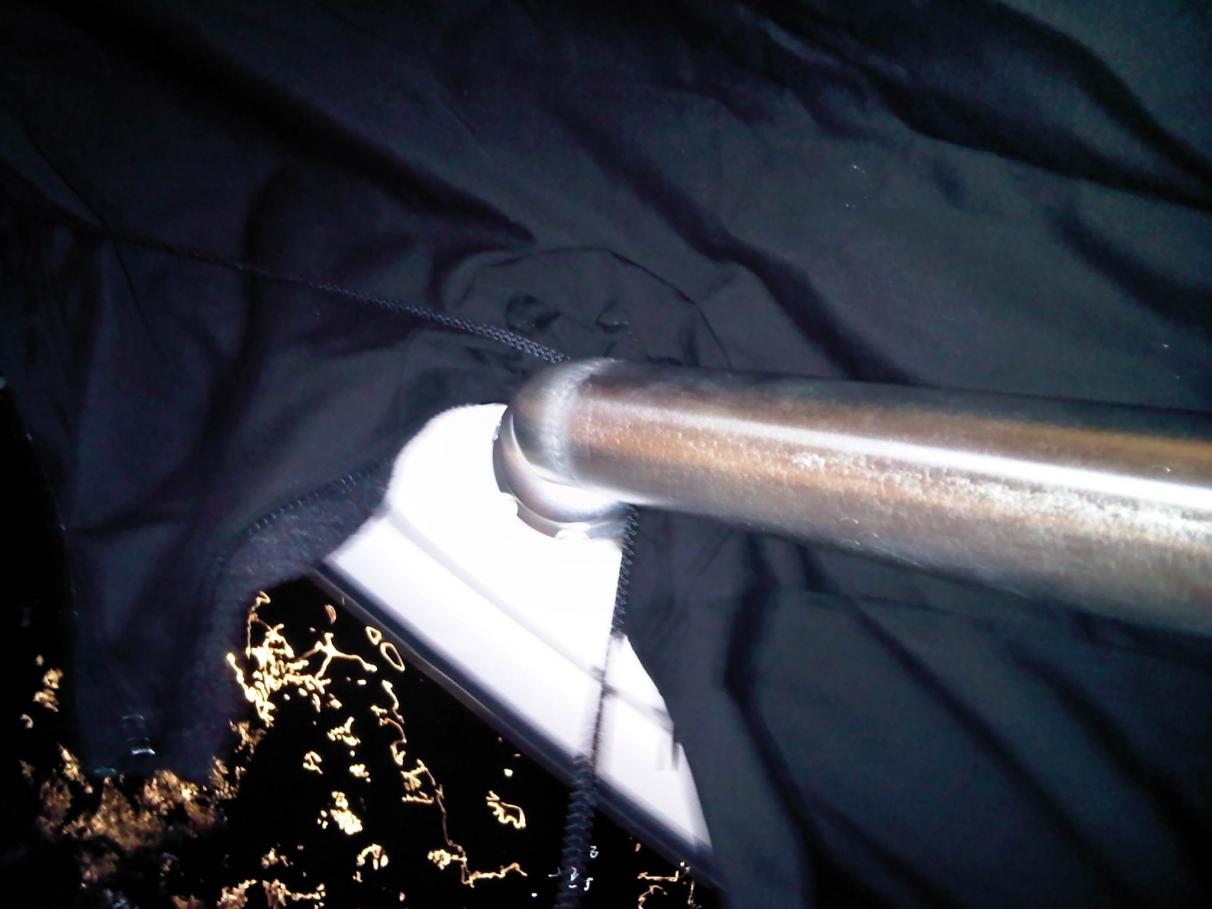

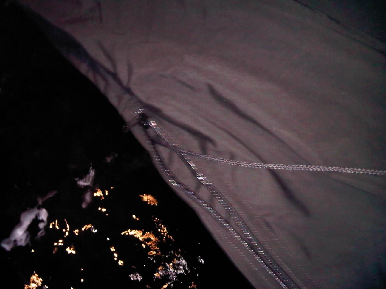

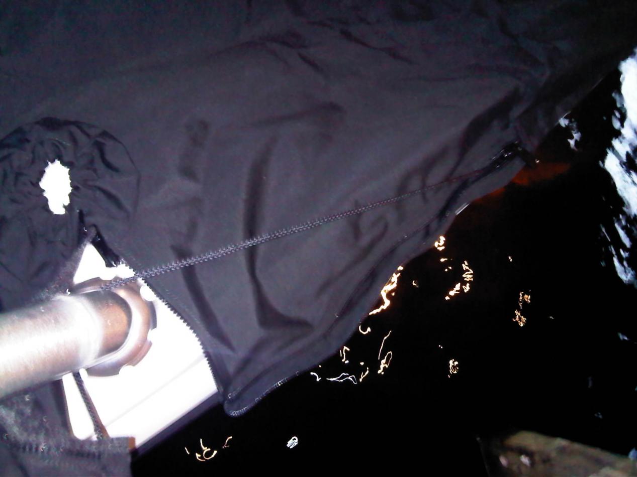

    The problem I'm having is, after putting it on, the rope that goes from the bow back towards the stern is on the inside of the tower. It needs to be on the outside so that I can zip down the cover around the tower. I don't want to pull the rope out because feeding it through the cover seems very difficult. I've posted some pictures to show you guys the issue I'm having. Describing it is difficult, unless I showed you in person - but the pictures will suffice. Thanks in advance!!

    You need to cut the rope at the center of each cut-out. That's what he was trying to convey in the email but obviously did a poor job. After it is cut, tie each end to some clasps so the rope doesn't get pulled into the channel and then you can just clasp them together after you zipper it up. I'll try and post a picture of how mine is, hopefully it will help you understand.

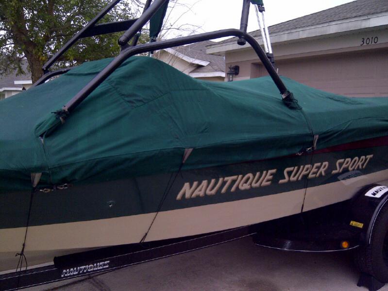

      Look under the rub-rail below my tower mounting points. Those vertical lines are the zippers, and the brass clasps are on the ends of the ropes, only mine mount to rings that are sewn in on the opposite sides. Same idea though, you can do this yourself real simple.

          He installs buckles on one side and you will have to do the other. Take look at how he does the one side and duplicate it on the other. Very simple process, just dont cut the rope too short towards the bow.

            As a follow up - you should install the tabs in the rub rail above the swin platform and connect the straps at the rear of cover first so you can pull the cover down tight. Then tighten the rope at the rear of cover before cutting the rope on the side he does not cut. You will likely get the buckle nice and centered if you do these steps first. All the parts i needed were included with the cover.
