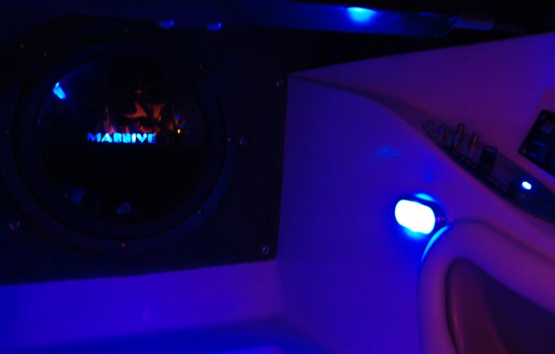

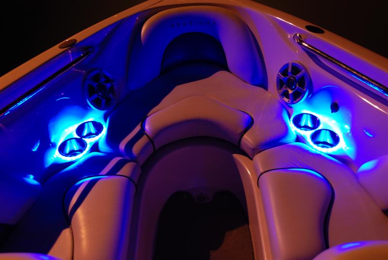

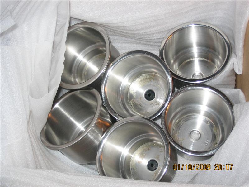

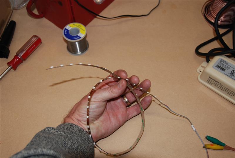

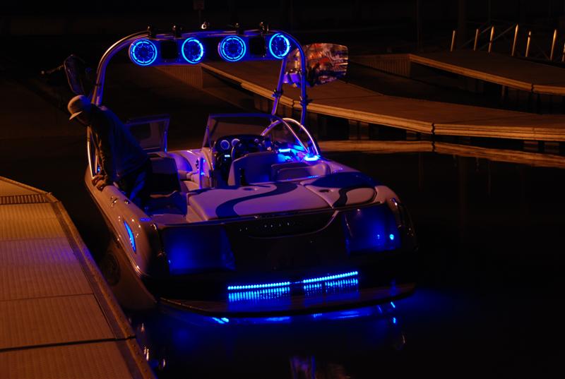

            I did my 211, here is the deal.
            I would put them on a dedicated switch, when they are on you cannot see anything outside of the boat and cannot even idle around. At a minimum, add a overide switch under the dash so you can turn them off. Blue attracts bugs, so does white, I have now had both after getting a ticket for my blue LED speaker rings on my tower speakers (blue is reserved for the marine patrol). On the 211 the cupholders in the bow, near the pass through and behind the driver are so close to each other you really need the ring to be flush with the outside rim of the cupholder. I had my rings made at Tap Plastics. They used a lazer to cut them which left them too clear, I sanded them to dull them so you didn't have to look at the copper circuit boards. If I would have used the white plastic covered flexible strips the clear would have been fine.
            Take note, my cupholders were not very consistent on the outside rim diameter. I suggest you pull all of them and verify the exact dimension before you invest in the rings. I ended up buying another 6 cupholders before I got a consistent set.
            While it seems like this should be a cheap and easy upgrade, it is not. It's not that hard either.
            I also changed my stock lights to blue while I was at it. I didn't like having some blue and some white. Today everything it white.
