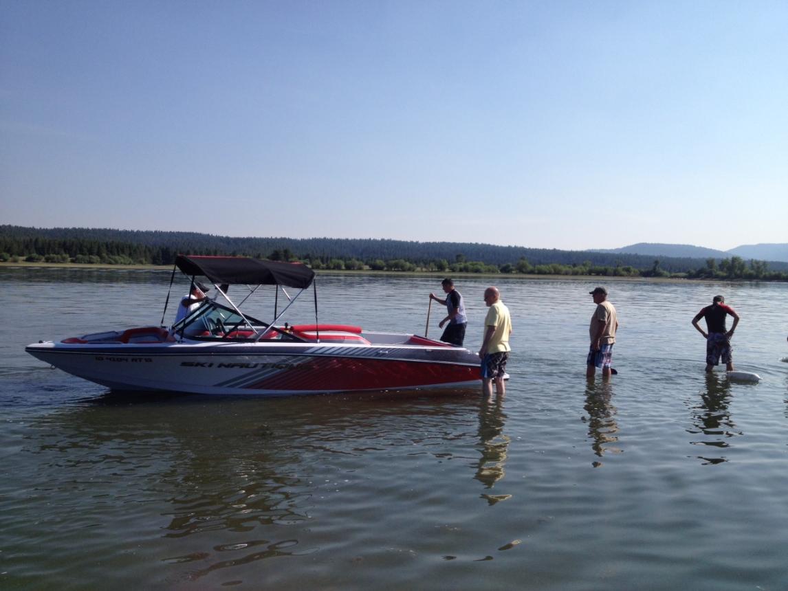

              I didn't have to wonder what I hit, I was standing on it! Fortunately there was no damage since I beached the boat in mud. You know your in trouble when you have to get a shovel out get your boat unstuck.
