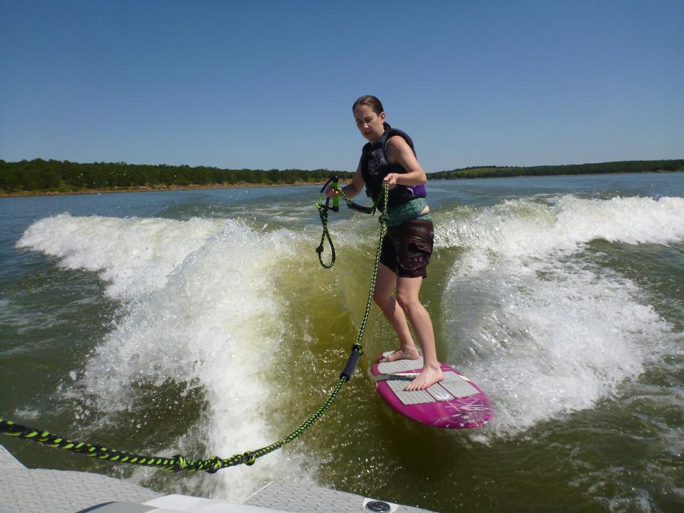

    Surf:

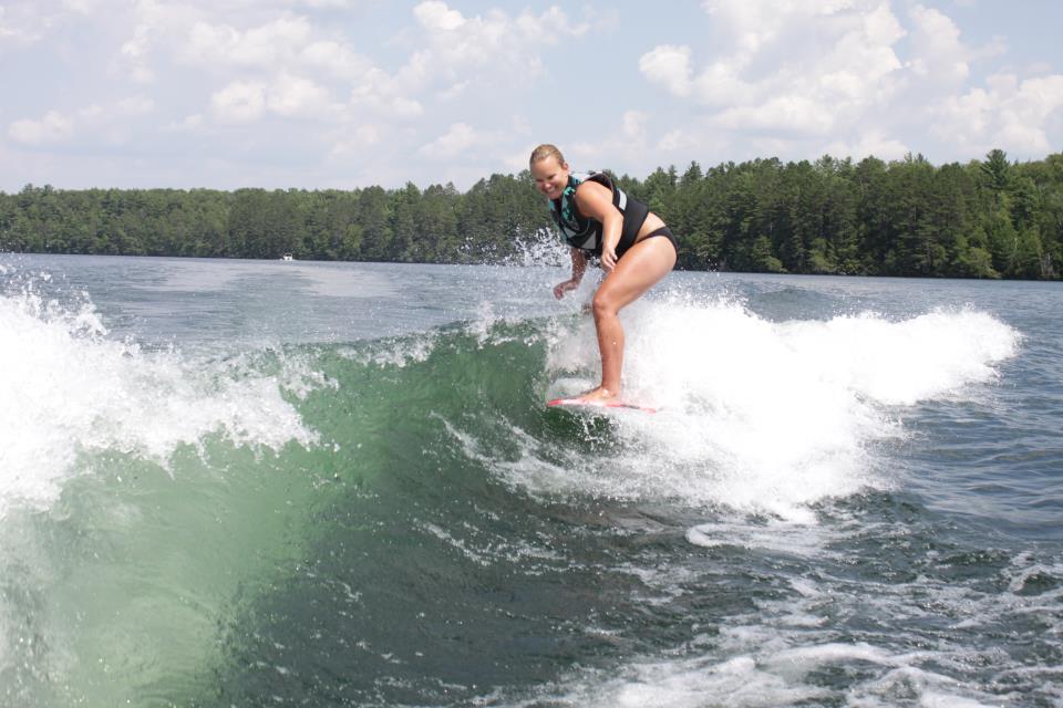

    All three tanks full again, I put a 750 in the port locker and a 750 on the passenger seat. I have the gate back and again 4-5 people. I usually pull around 10.8. The wake is pretty good but would like a bit more push for the larger riders. Below is a pic of the wake I have now.Click image for larger version

    That wake is sick!

      So even if you are surfing on the port side, you still fill up the starboard side?

        Love the clean water, wish we had that in TX. The wake looks great.
        For surfing I would try empting the starboard and if your sack in the locker is intergrated with the factory pumps make sure it is not siphoning out. How close is your air vent to the water? Also, do you have trouble keeping the 750 on the seat?

            This is my surf setup. Full factory ballast front and port tanks. 750# fat sac in port locker and full 650# integrated bow sac with 400# fat sac on port side passenger seat. Hydrogate set at midposition.

              Hey all,
              I have left my starboard tank full to give some balance.I am getting close to the water with the air vent.
              I keep the ballast on the seat with assistance from the cooler
