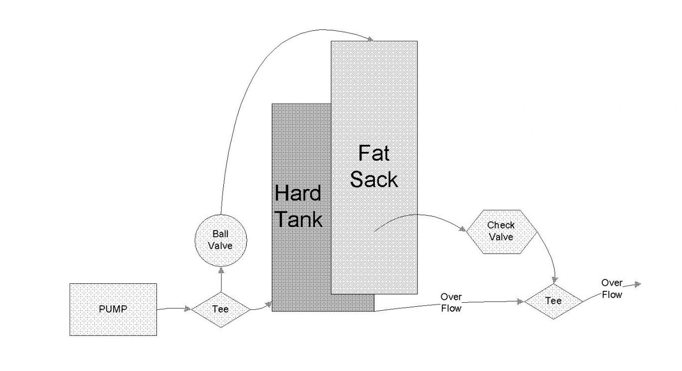

    I know a lot of us with integrated sacks are worried about our hard tanks. I was talking with wakemakers today and this may be a possible solution. The question is where to put the ball valve so it is easy to get to.

    How does the sac drain -- is the ball valve two way?

      i didnt learn anything looking at the diagram. if using hard tanks i assume they would overflow into the sacs, and vice versa to drain. i removed my hard tanks so i dont have to deal with this anymore, but am intersted in what they recommend...

        I have two questions about that diagram. 1. What's the point of the check valve. This picture doesn't show which direction the check valve goes. 2. Splitting the fill side looks like it will make filling the bag take forever and a day since the hard tank will most likely fill first (lower, gravity) and then just start pumping water overboard.

          i may be wrong but unsure how it would work...wouldn't the check valve keep sac from emptying? you need air to flow back in to sac, right?

                I dont see the above diagram working for the simple fact the tee in the overflow will not FORCE water in the tank, it will allow it to go out the overflow which is the least path of resistance. Lose the checks and put the ball valve between the tee and the sac on the overflow side and it would work. Close the ball valve when filling the sac and open after the sac is empty. That will allow fresh air to bypass the sac to the hard tank.

                        To try to answer the questions...The ball valve is two way and the check valve is set so water will flow out of the boat. The idea was to fill the hard tank first and then if you wanted more weight open the ball value and fill the sack. Since the boat outlet is higher than the sack the water would flow to the sack. On the drain the idea was the hard tank would always have air but the sack would not. IF the sack collapsed it would not get hurt. The water would drain from the sack to the hard tank and the check value would close and help the pump pull the water from the sack to the hard tank.
                        This is not my idea, it is what WakeMakers suggested unless I wrote something down wrong. I was fearful that on fill it would just spill out of the hard tank and on empty it would suck air from the hard tank and not water from the sack. The principle that water seeks the lowest level may be a play here on the fill side and, if draining the sack, all plumping may need to be higher than all the tank fittings. It appears that some of you share the same thoughts. But I want something there to keep from having to babysit draining the sacks.
                        I can see this working if the ball valve was Y but then you would be filling and draining each tank\sack separately.
                        I will send the diagram to WakeMakers to ensure that I have it correct. I may give it a try but hate to spend the money on parts and have it fail.
