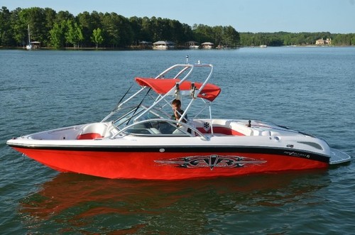

    At the beginning of the season I got a new to me 06 SV211 LE and was wondering which tower it has? Also any one know what the tube diameter is for this model? I am pretty sure it is 1 7/8 but want to make sure. I need to get a tower mirror.
    Thanks,
    John

      The tower is 1 7/8", the rear tanks a either 150 or 200#s each can't remember exactly, my belly tank holds 300#s but I rarely run it more than 3/4 full for wakeboarding. We do fill the belly for surfing and it could take more so I would recommend a pillow shaped tank there. You should have a front drain plug that you can replace with a fill hose or just tap off your raw water intake (don't run more than one pump off the raw water intake or you can starve the motor, it also needs to be an impeller pump not an aerator). I replaced all of my fill pumps with impeller pumps and ditched the flow-wrong and TH Marine valves, no more ballast valves in my boat.
