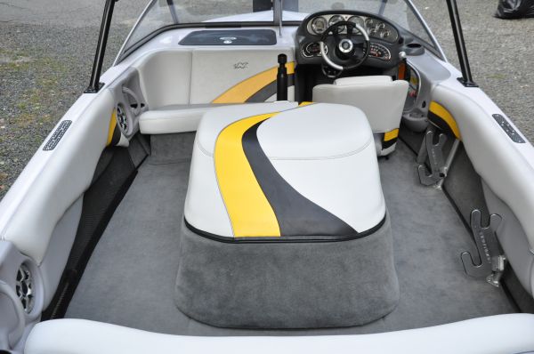

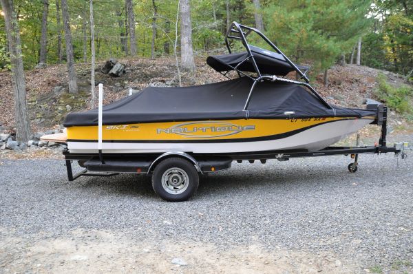

                    Are the attached pictures of the Nautique Ski 196 with the Flight Tower showing up? My question is if any one has experience doing one of these not from the factory -AND- which Flight tower (year/boat model) would I order from Correct craft? Thank you again.
Name:	2005 196 CT 27000 ASK 02.jpg
ID:	364502 Click image for larger version
Name:	2005 196 CT 27000 ASK 01.jpg

                            I have done a fair amount of work on a 1998 Ski Nautique that has a factory FTC 1 tower on it. The tower was made to fit the Ski Nautique hull.
                            I believe the tower was ordered through West Coast Correct Craft, the regional service center at the time. Contact SBRS on this board. Bob Bense was the head guy at West Coast Correct Craft, and is the head guy at the Nautique dealer in Rancho Cordova now.
                            In spite of my advise not to, the tower was used to pull tubes. This did cause some minor gelcoat cracking at the rear starboard tower mounting pad.
                            Correct Craft did make a tower that fit the TSC 1 hull. (1997 through 2001 Ski Nautiques.) During this time Correct Craft also modified this hull for an open bow, the Ski Nautique Open Bow. These boats could also be obtained with a tower. I do not know if it was the same tower, or if there were some differences.
                            It is also very possible Correct Craft no longer has towers available for the "older" Ski Nautiques.
