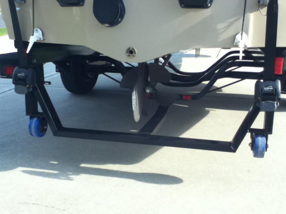

        Here's mine. I also had the same problem. Got the wheels from Grainger. Rated for 1500 lbs. each. Welded them on with a friend. It's amazing how often they are used when driving around town. Click image for larger version
