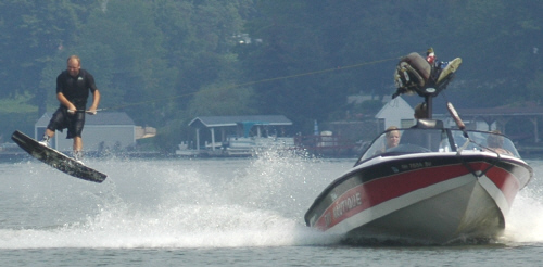

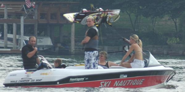

              I had a 1997 and we would put 700lbs in place of the rear seat. It was not a MONSTER wake, but it did the job. I don't have any pics of the wake, but have a couple of us behind it. 60ft rope and 20mph worked the best. We never tried to surf it.
