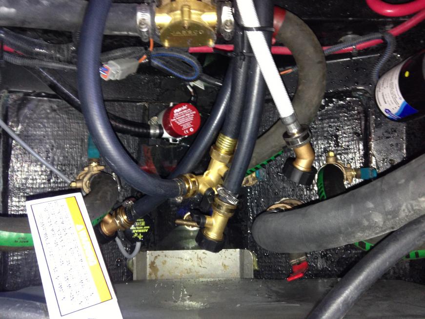

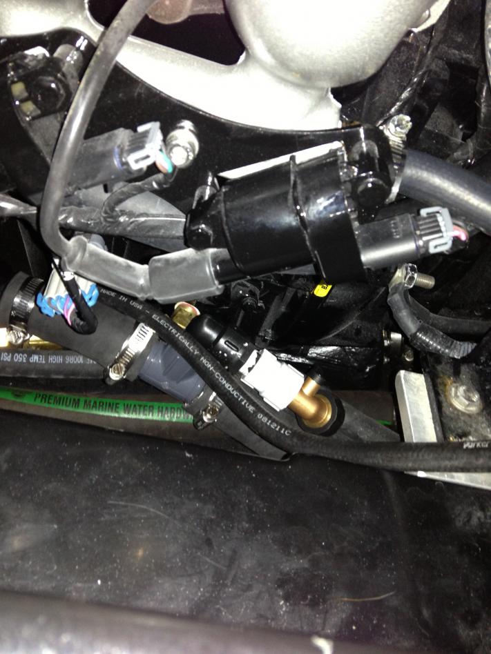

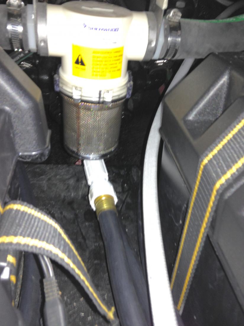

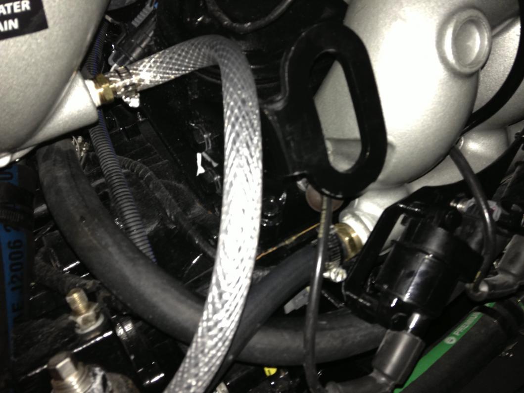

    We use the boat year round although we have to worry about below freezing temperatures for about 4.5 months. PCM recommends removal of 8 items to completely drain the raw water on the newer models. Not terrible, but I hate the recessed square end pipe fittings, especially the one under the transmission.
    Finally connected all the fittings to hoses with simple brass on/off valves. Even made one for the bottom of the raw water strainer. Now just open several valves and let the water drain out.
    I need to tidy up the loose hoses, but at least it is now a 30 second procedure.

    Nice work! I have a similiar setup to maximize my boats use in chilly Colorado. A word of warning though. Last year after draining everything, I was getting ready to run the boat agin since the air temps had warmed up a bit (we always get one snowstorm in early/mid Oct). I tightened it all back up and started it up. I monitored my intake pump by looking at the plastic strainer and saw positive flow. I let the engine warm up and got ready to surf. After about a minute I realized blue smoke was coming from the exhaust. I stepped back on board and had my wife shut down the engine as temps were over 200 (no horn yet but the sensor might not have been immersed!!). I swam it back in and got it on the lift. Bottom line -- the engine overheated due to a loss of suction. Only some minor damage on the exhaust pipes due to the heat. -Marc
    Moral of the story:
    there are a lot of potential vacuum leaks when you have this setup. After a quick drain you MUST ensure everything is completely tight. Just a slightly loosened cap could cause disaster.

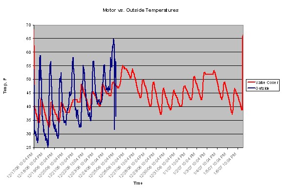

                              I logged these temperatures several years ago and came to a few conclusions. If the average ambient temperature stays above freezing and if your boat is covered and if it gets some sun during the day it is unlikely you need to worry much about freeze damage. On the other hand if the sun never makes it through the clouds and the temperature only goes a few degrees above freezing then you should be worried. I have a swimming pool and it rarely freezes over but it has. When puddles and pools start freezing then you should start thinking about protecting your boat from freezing. In the San Francisco bay area I have zero concerns about freezing when my boat is in it's unconditioned garage.
