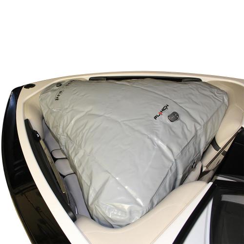

                          do any of you guys have experience running this bag on top of your bow seats? im considering running this to avoid cutting out the cooler but am concerned it will damage the seats over time? would probably only need it half full since it claims to be 1000 pounds worth!

                            I'm running this exact bag , full. as far as the seats go, it's been ok so far (4 years) but it's such a PITA to fill/empty. Also it takes up so much space even when empty.
                            any one can help with the plumbing route? I want to put my order in!!!!
