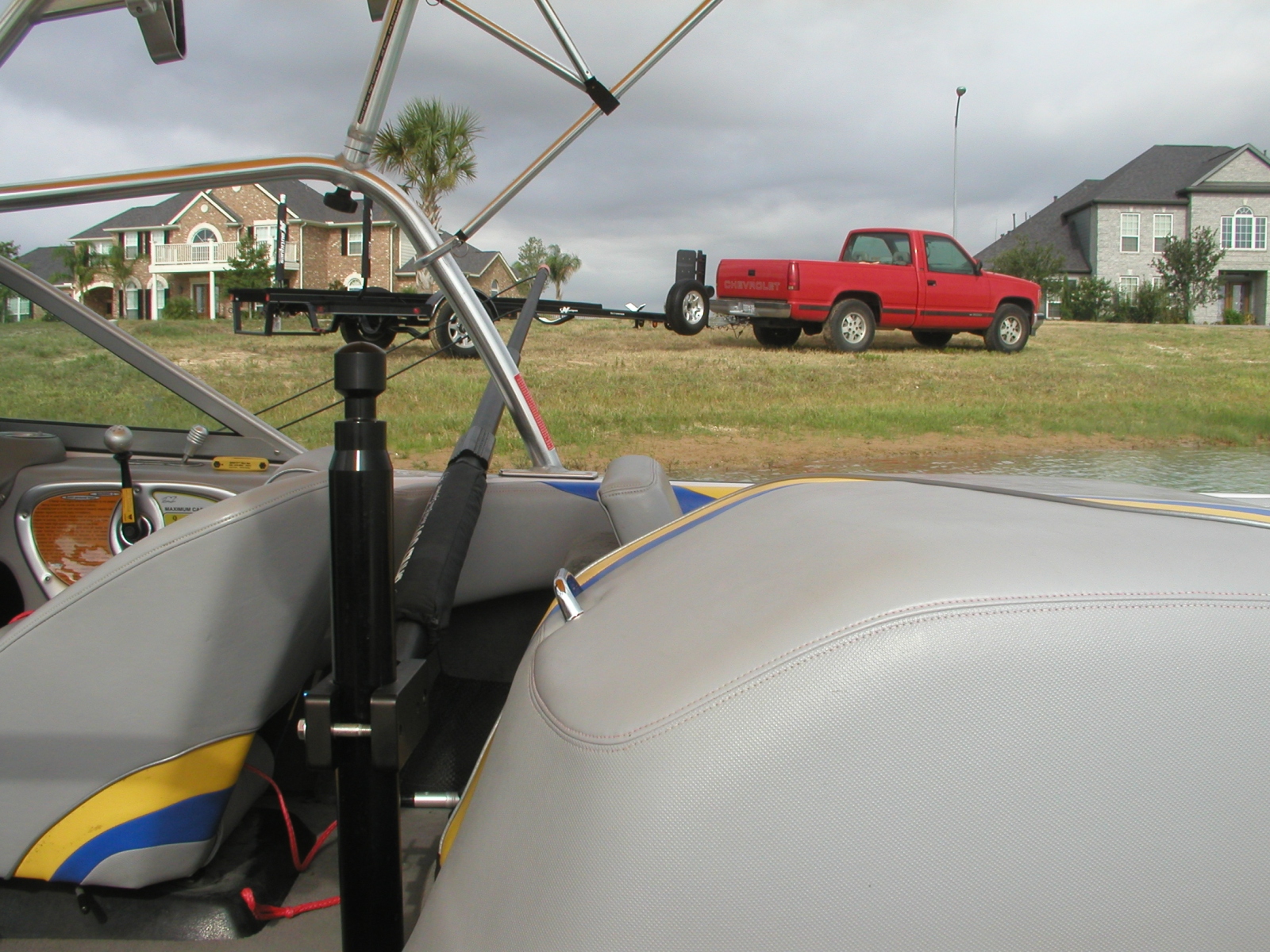

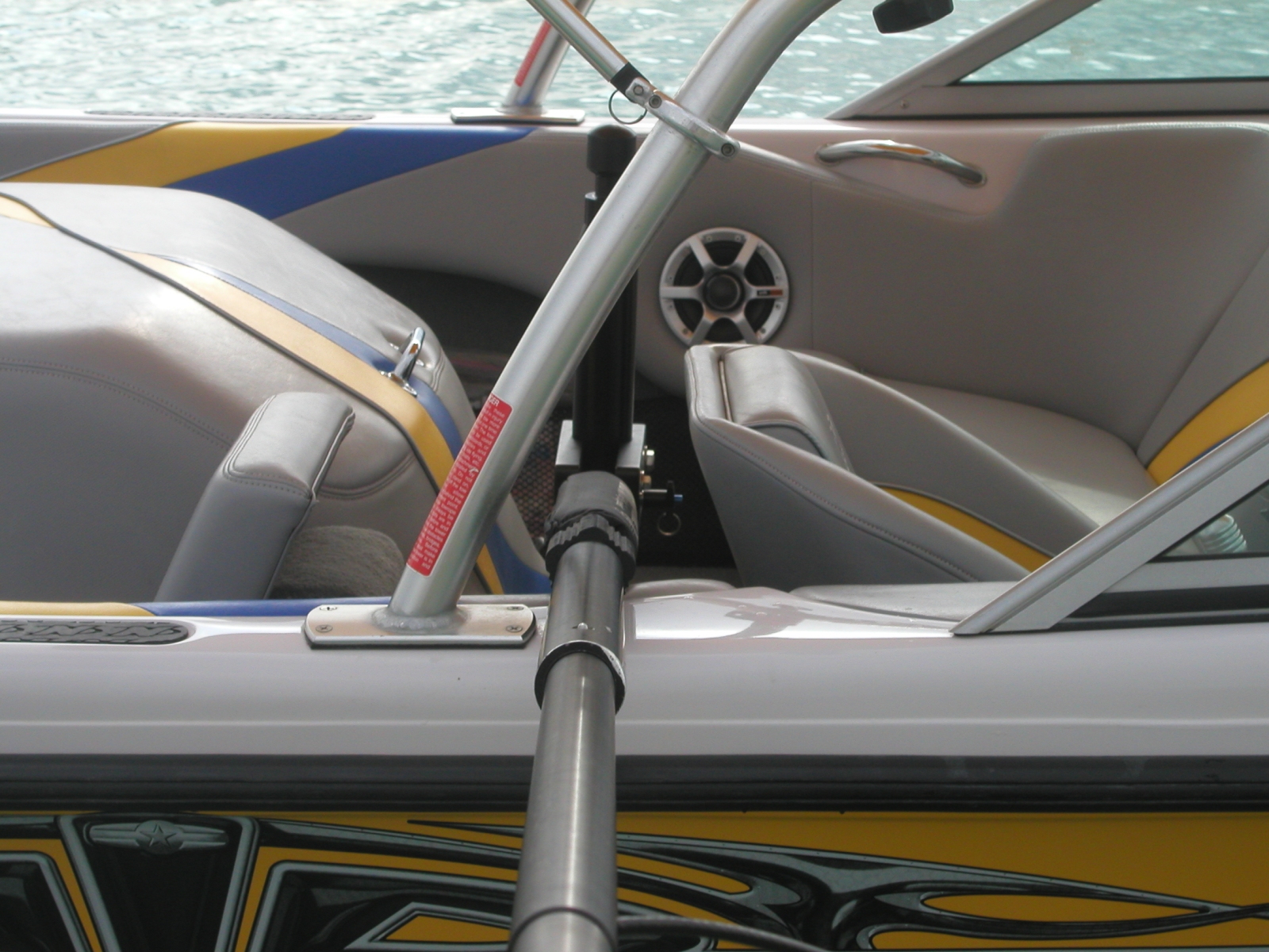

              Originally posted by Davidpsalt View Post
              Thanks Quinner!
              Would love some more pics - specifically how it attaches to the tower. Does it clamp around the tower or is it drilled and screwed to the tower?
              I have same as Quinner's. The tower supports are clamped on. Here are some pics of the boat w/tower. I think I have some close ups of the clamps because i sent them to towerbimini (Mike?) when I had some questions. the boat came with a white top with a weird splash of yellow and blue. I bought a new canvas in the yellow which looked much better and high vis on the lake. It also blocks more son. The darker the canvas the more it blocks the sun....but they can get hot.
              I'll look for the clamp photos...and would definitely buy the same cover again.
              http://www.planetnautique.com/vb3/sh...ol-s-06-206-TE
              You can see the clamps in these photos. One on each side forward and aft.
              https://www.planetnautique.com/vb3/a...3&d=1248323954
              https://www.planetnautique.com/vb3/a...4&d=1248323927
