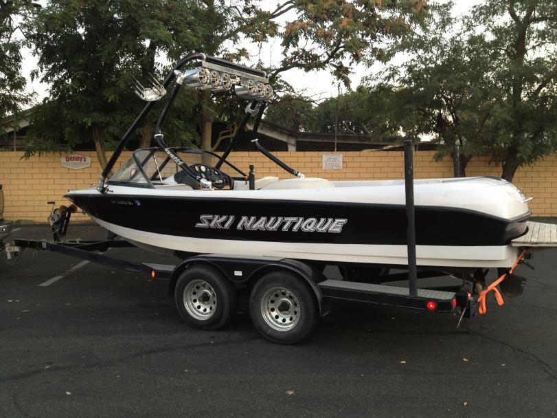

        Here's kinda what I was thinking... pardon the crude photoshop... also the tower is no longer there... so ignore that. It was the only picture I had that I could make work...
        Either way, I want to make the stripe a different color and upgrade the graphics to a newer style.

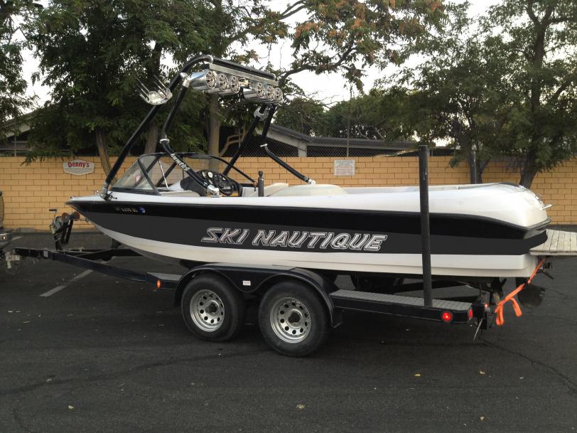

                  Ok, reviving my old thread here. I'm finally getting around to doing this.
                  I bought the Oracal 751. I'm working on the template now. I ended up buying a cutter for my wife GCC Expert 24. Not the greatest I know, but it should do the job. I think the problems I'm running into are:
                  1 - I'm trying to do this in 2 pieces. One on port, one on starboard. What's the best way to wrap the strip around the bow and the transom so they can overlap in the middle.
                  2 - Anyone have any idea how to prevent this from slipping out of alignment during a 30' cut?
                  3 - Wet application is the best?
                  The other option is to take the template and draw it on to the vinyl... then hand cut it. I still run into the bow and transom issue.
                  Advise?
                  Come on sign guru's!!
