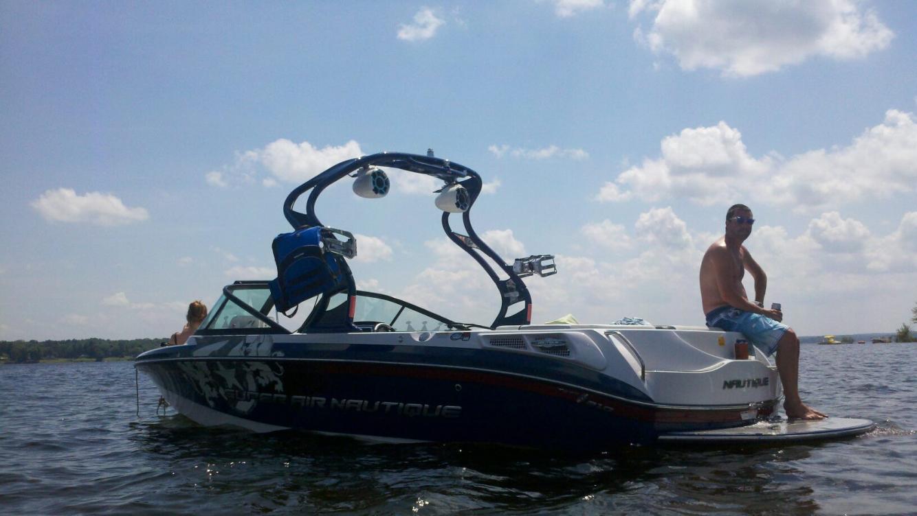

            I follow the same exact process the HS outlined above. It allows you to also point your speakers at the beach!
            Nice write up HS!
            Example of how to anchor
