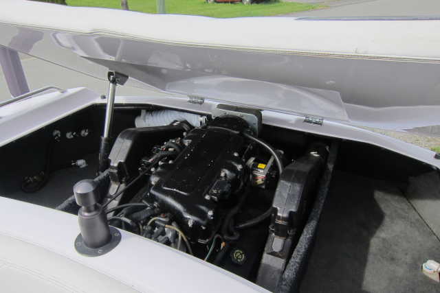

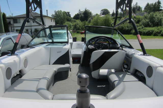

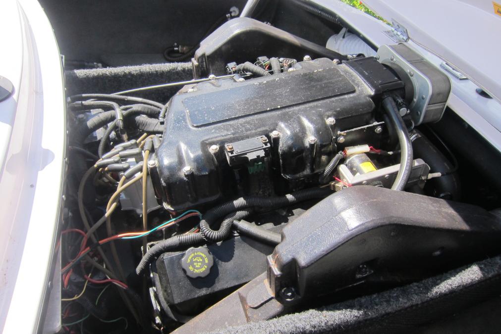

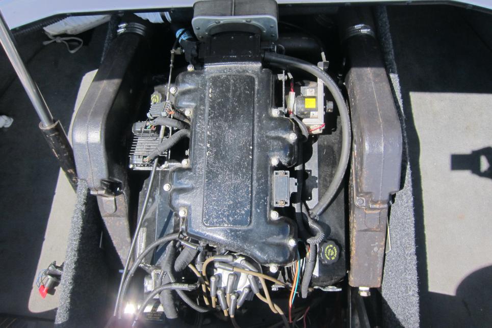

    Hey guys
    i have a 2000 SAN with the 502 Python. as you can see in pictures its missing the snake sticker and the wiring is a little un organized which is driving me nuts!!
    it's almost impossible to find and pictures of the python motor installed in a SAN so i was hoping someone could post pictures they have of their own so i can get an idea of how mine is suppose to look
    thanks!
    any anyone have a lead on a shop manual for the 502 motor, all i can find is the 496 PCM manual

        Congrats on the big block! 502 is the more rare of the python engines. No manuals. I was lucky enough to get a list of part numbers from the original engine build sheets. A lot of parts are shared with the HO 454.

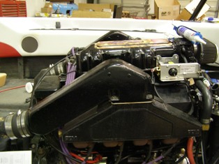

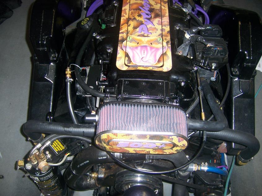

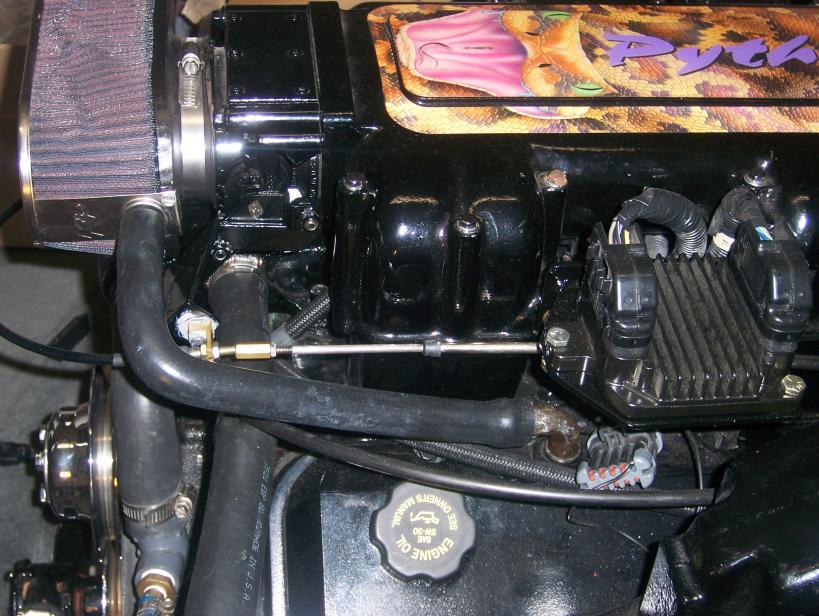

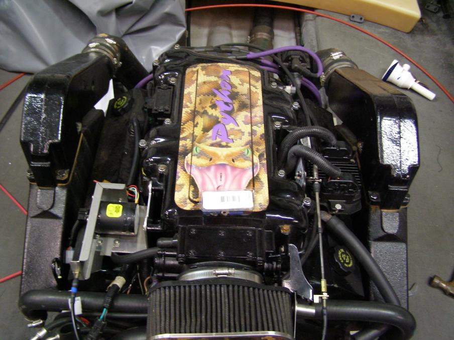

                          Here's some pics of a Python, a couple of my ex-boat, and another from a member's Ski (!) @ Zach, I only have a paper copy of the dyno sheet, I need to remember to scan it in...
