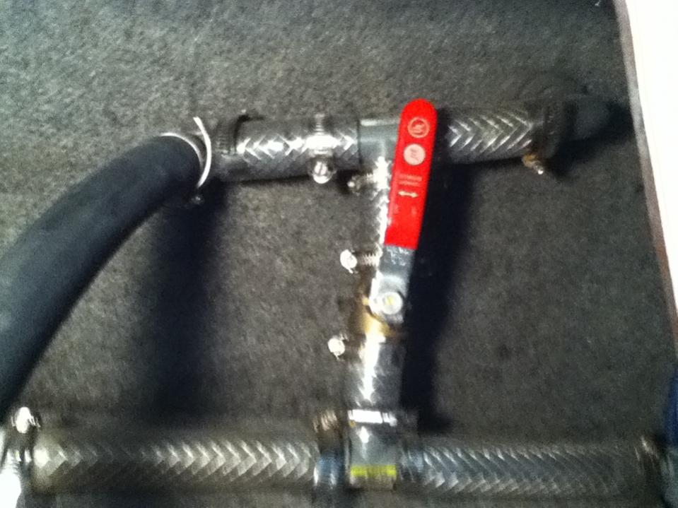

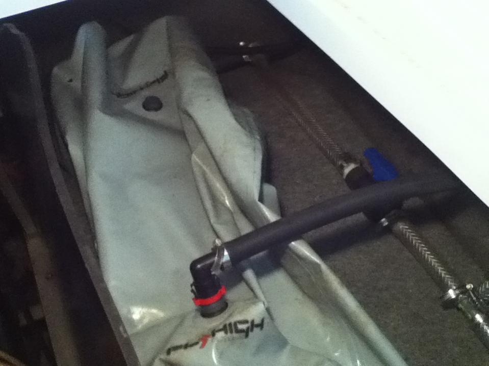

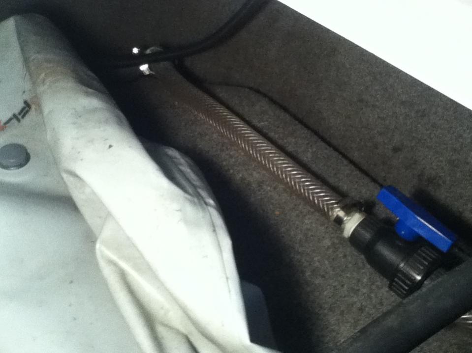

              Thanks for all of the help guys. This what I am working with. The first pic (clear hose with blue handle) is the hose that the water fills/drains out of. The blue handle allows me to shut them off if I don't want the extra weight. The second pic is my ventilation setup. The red handle lets me turn the vent off or on. The third pic shows the whole setup in the rear trunk. Swankster: I was a little confused by what you were saying about the venting changes I need to make. Maybe these pics will give you a little idea of whats going on.

                What a overly complicated mess that is. Basically if you open your blue valve and close your red valve you have what most of us all have with our piggy back systems. Yours is just overly complicated did i say that already? If I were you I would just get ride of the whole works including the 400lbs bags and get some 750's. To piggyback; the line that has the blue valve is your bag fill. The line coming from the bag going into that t-mess is the overflow/vent line. You can always control how much weight you are running by how many times you press your fill buttons.
                I think your problem draining was that you had the red handle valve in the open position. Prob not good for your impellers on your pump as I bet you were sucking lots of air.

                      Having studied the pictures, I think Nordi is right on. On the drain cycle, that clear fill line is acting as a vent bypassing your sac so your pump isn't pulling water, just air. And, yes, running them dry is something I try to avoid, as well. Nordi is also right, that if you open blue and close red, you'll achieve the same function as a piggy back system. You are right to be concerned about air lock, so run the tube Nordi shows, or mechanically fasten the sac so it cannot go flat after it is empty. That is because air MUST pass thru the sac as the hard tank continues to empty -- otherwise, the pump will bend the hard tank inwards due to the suction force created by the pump, so be sure to keep an airway thru the sac (my dealer tells of bent "senders" having to be pulled out of the tanks).
