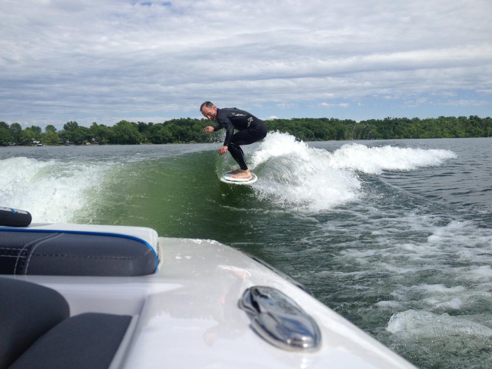

                        Here is a shot from Saturday. With NSS configuration. It doesn't show the great length of the wave but you can see how clean it is!

                          Yep thats a clean wave there. The challenge is for these guys without NSS. They gotta slam the boat real hard to the rear surf corner and lean it hard to achieve the same results without NSS.
