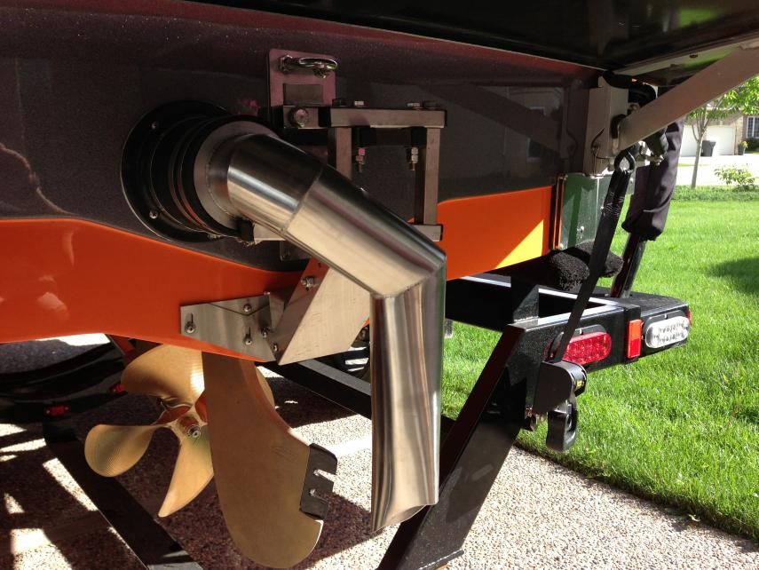

    Just got the new brushed stainless FAE installed. Should be able to test it out Sunday or Monday and will let you know how it works. I love the finish. I guess they are eliminating the black finish.

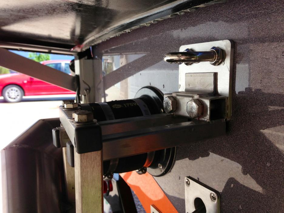

                This one cost $420 + $40 flapper. I actually had the dealer install it which cost me more but I am short on time so it was worth it. I hear it can cause a rooster tail but otherwise I have heard many more positives. Here is a pic of the mounting point.

                      Went out today and this thing performs as advertised. No visible exhaust, slightly quieter and no effect on surf or wake wave. No rooster tail. The boat was quieter but I have always thought it was quiet even before the exhaust
